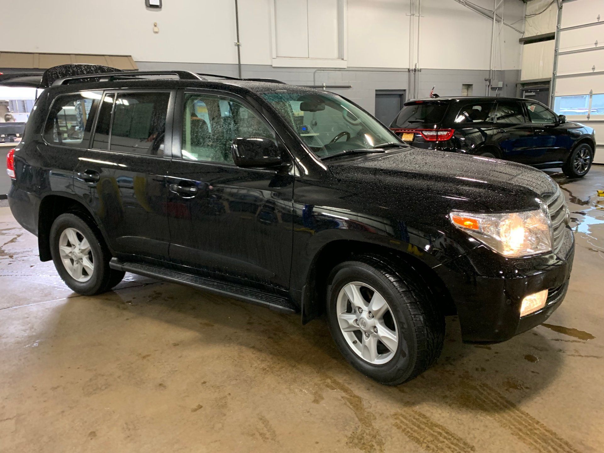

Well I ended up bringing home a nice used 200 Series Land Cruiser.
2010 with 35k miles.
Not good pics but pics. I did get to look it over inside with it washed and dried before taking it out in the rain.

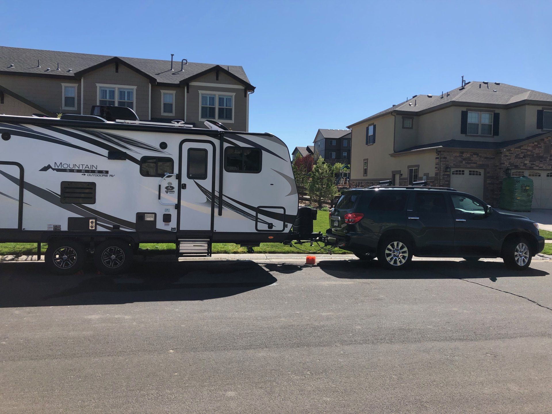

FWIW I tow a 5,500 lb dry weight travel trailer with our 2008 Platinum (AHC) Sequoia at higher altitude - it's probably 900# more when loaded. I'm very happy with how it tows - it's stable and has enough power. I use "tow/haul" mode and manually shift as needed when climbing passes. The limits are largely the payload capacity (+1200#) and a smaller gas tank than the Tundra (we can travel about 150-180 mi / tank...that's a very rough guesstimate).
