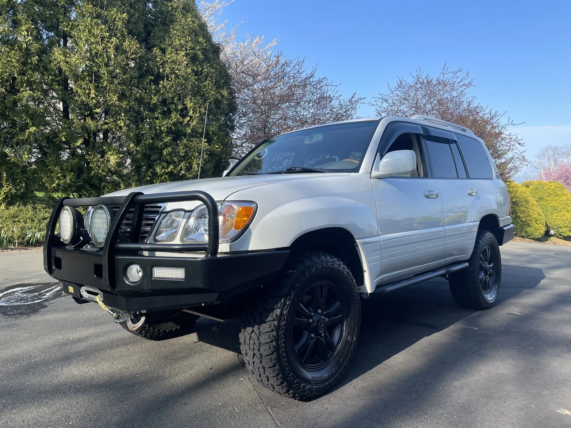

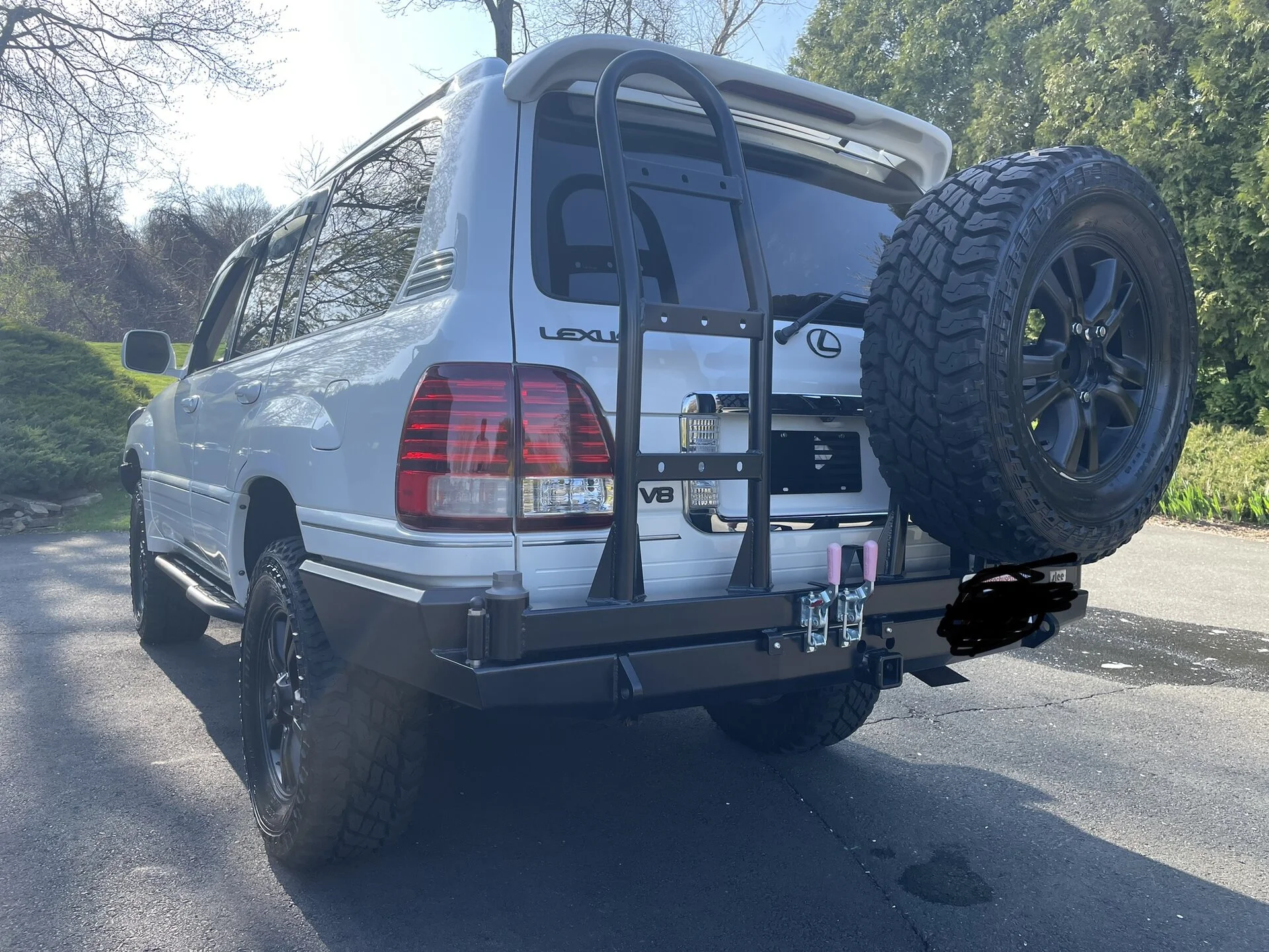

Good afternoon,
I was hoping someone could point me in the right direction on how to cure my suspension woes.
Currently using the tough dog shocks can’t recall the style but they were the better ones with rear adjusting front and rear along with TD torsion bars and constant load heavy coils. Longer sway bar links and diff drop, Upper total chaos control arms in the front and rear upper and lower adjustable tough dog control arms.
The truck is fully kitted out with front metal bumper, sliders rear slee bumper, drawer system and fridge. The rear suspension seems to be doing OK but the front just doesn’t feel planted at all and I can feel every bump in the road, hit a pothole and you practically go through the sunroof. Is it my torsion bars or are my shocks just not doing their job? Any help is greatly appreciated.
