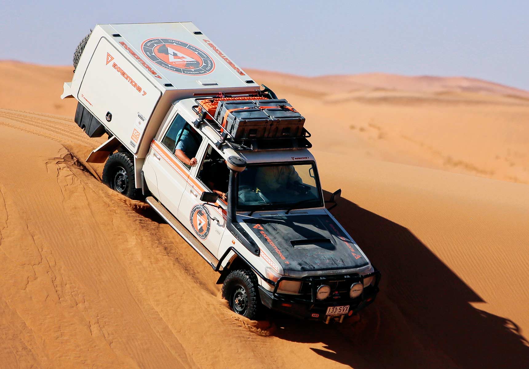

Andrew St Pierre White is a South African 4x4 journo who has moved to Perth, not that far from me.
A few weeks back he bought a dual cab 79 series and began to deck it out for overlanding and producing his YouTube videos, but now has his doubts about it.
The bit where he thinks it will have too much weight on the rear doesn't make much sense when you have a steel bull bar, V8 diesel up front to offset the camper
Bad call I think as he originally bought the dual cab for his daughter to come along.

I thought it strange that he mentions taking it on scales without mentioning the weight on both axles, instead of talking about the weight on the rear axle only.

Exactly, I was going to add that but forgot.
Troopy is better suited for building living quarters. Can spread the weight better . I do not like over landing vehicles that have the cab and living quarters separately. Going from sleeping position to the drivers seat without exiting the vehicle is quite a nice thing. I think he is trying to build a pop top camper like his previous Troopy. Ouh also Troopies do have seats in the rear
I think his proposed camper puts too much weight behind the rear wheels. For two person travel, I'd choose the troopie as well. But if he wants the luxuries of this camper, I'd opt for the single cab 70. Perhaps, an 'Extra-cab' would be more ideal.

I think rear axle weights can get to be a problem but it depends what terrain you intend to cover. I don't think it's a massive problem, more of a mental one. Rodney (wholesale automatics) and Glen Hadden (AAMS) on the 4WD action and low range DVDs both run very heavy rear ends in their DC VDJ79s and they sure make hard work of things from time to time even with quite heavily modified trucks (35s, auto, twin locked). Still, most people wouldn't drive the sort of things they do that far from home. Though Glen getting so very bogged on that beach in the gulf shows it, if he was by himself the tide would have ate it.
I think a lot of these people trying to build family campers where everyone sleeps in or on the car would be a lot better off with something like an Iveco Daily or just using tents/roof topper/camper trailer with the family 4x4 wagon/IFS dual cab like everyone else does.

The weight he usually puts on the front should compensate for the weight on the rear, more so with the 1VD engine.

I wonder what the rear axle weight of the camper fully loaded would be given the moment of what's aft of the rear axle?
Also, it is my understanding that the weight on the front such as the bullbar would bring your center of gravity fore a bit, but you're still increasing the psi exerted onto the ground so you'll increase how much you sink.
