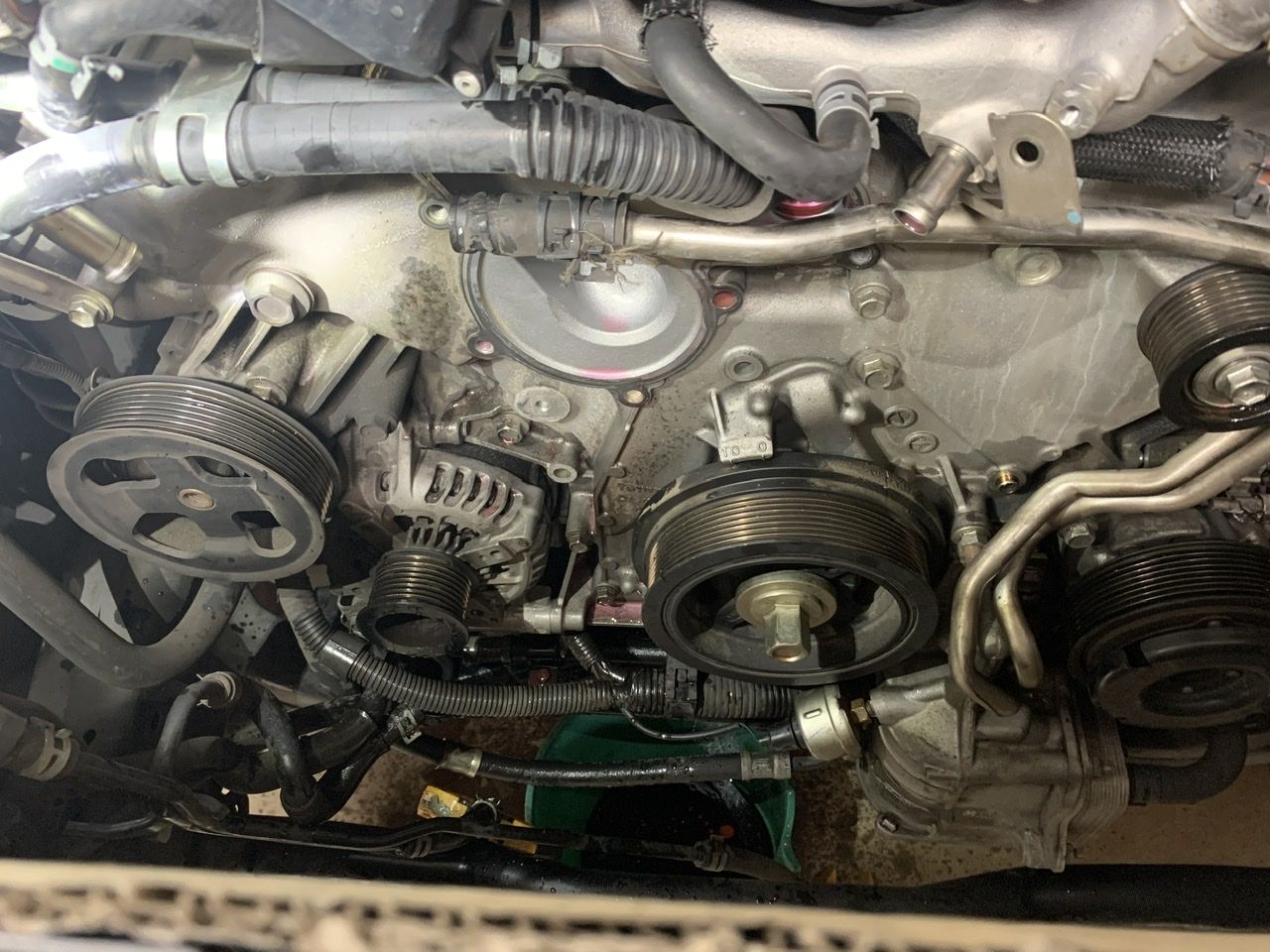

At 228,000 I'm replacing my radiator, water pump, thermostat, serp belt tensioner, fan pulley bracket, fan clutch, idler bearing, valve cover/plug gaskets, and whole bunch of hoses.
While I'm waiting for a copy of the FSM, I could really use the torque specs for:
Fan belt bracket
Valve covers
idler pulley
Serp belt tensioner
Can someone post those for me please?

How many miles?
I would do a water pump, thermostat, upper/lower rad hoses, serp belt tensioner/serp belt. I'm also replacing the fan bracket, fan clutch and idler, but they had 228,xxx miles on them and still performed fine.

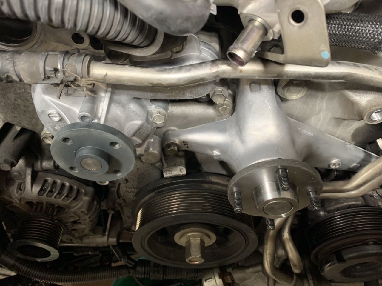

What's missing here? Fan to fan clutch (Fluid coupling). Anyone know that one?
Also - anybody using thread locker on Fan to Fluid Coupling and/or Coupling to Coupling bracket?
And finally - do you lube the thermostat gasket with anything? Or dry to the metal housing jacket? Any locker on those nuts?
