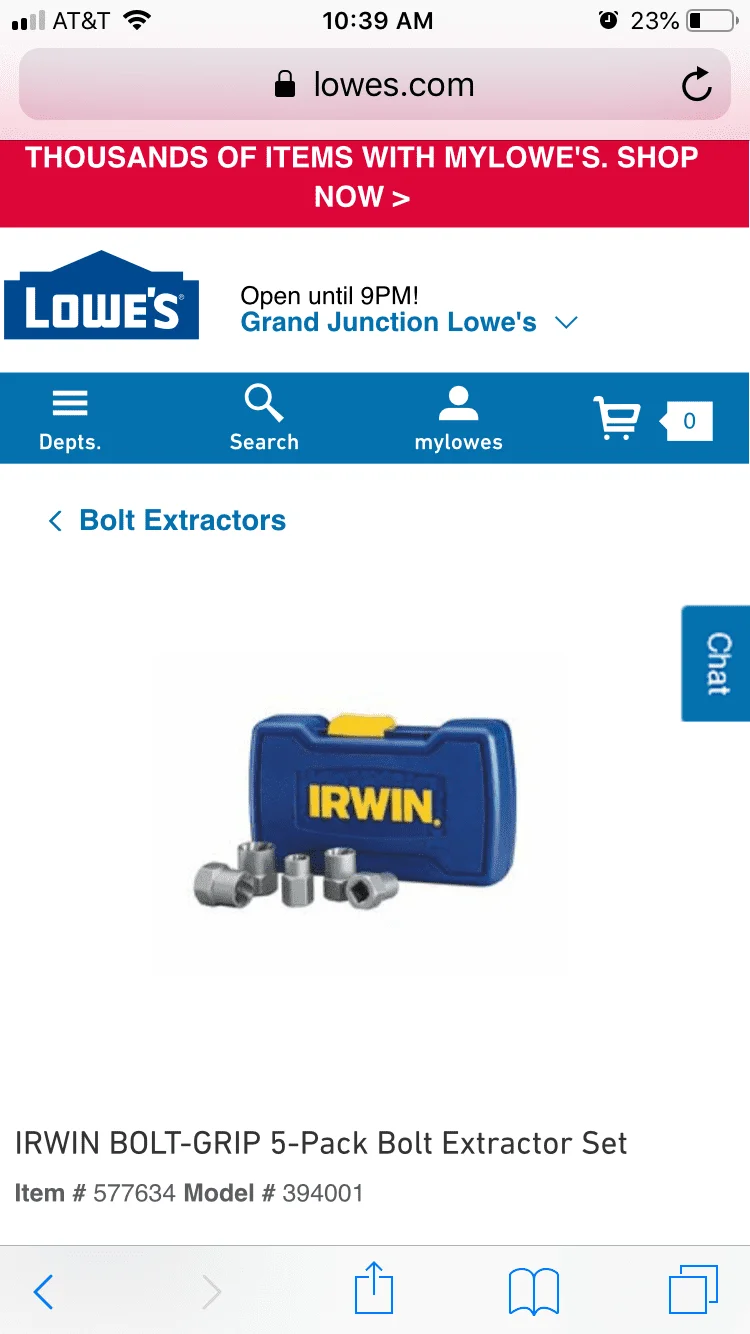

@jaymar get you a set of these Irwin bolt extractor these will bite into the nut or bolt and take off the nut. I have used them they work well. ...
