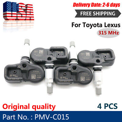

Just get this set, seller seems to have decent feedback. This is the correct PMV-C015, and a set of 4 new sensors is $40 (you'll need to get a 5th, I'd message seller):
