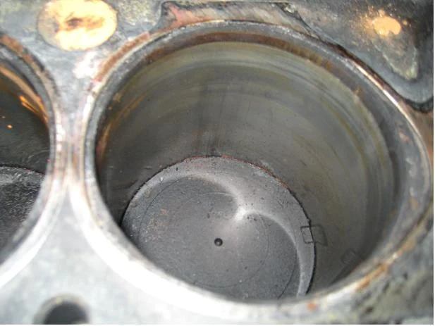

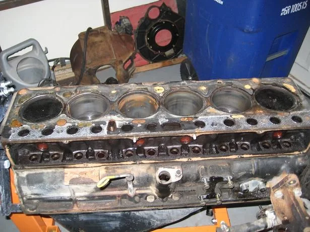

After pulling off the head, I think I going to overhall the bottom end too.
