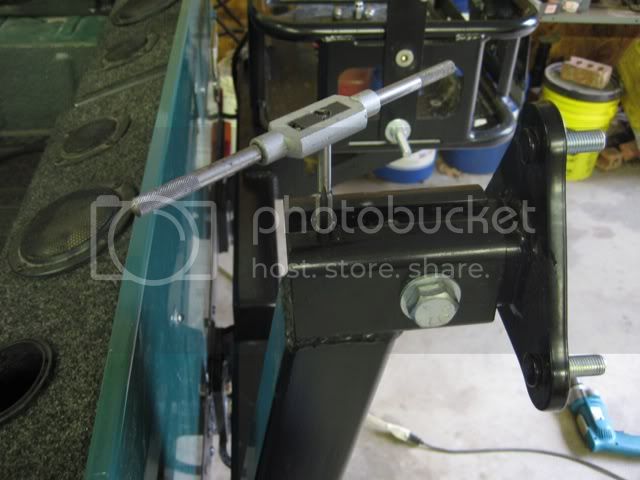

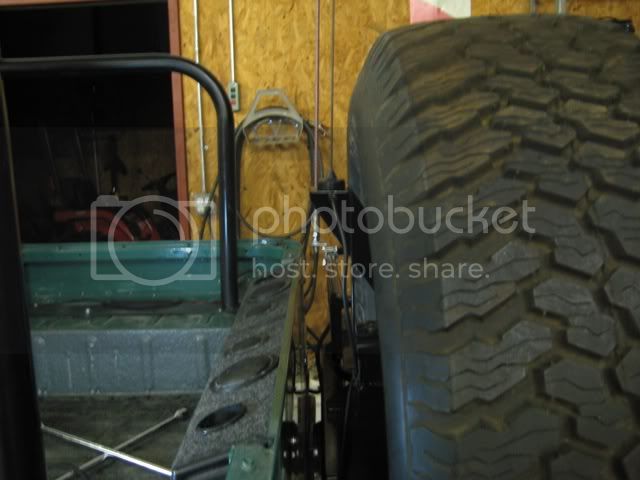

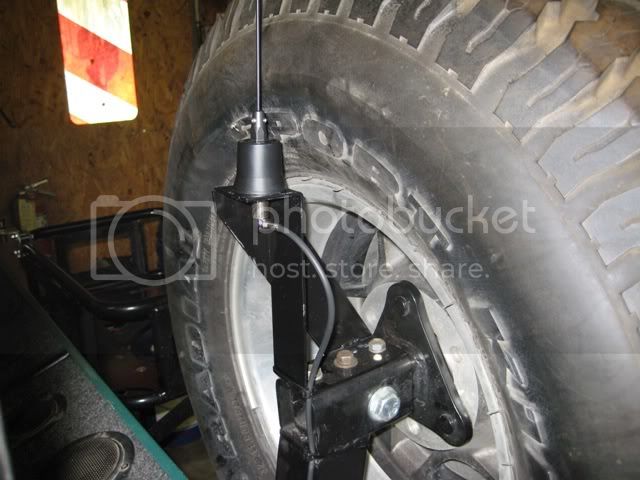

1911, where do you place your antenna?
On my spare tire mount:
The nice thing about a 5/8 wave antenna (as told to me by Cruiserdrew and Rusty_tlc) is it is not ground plane sensitive. Most of us are running the Larsen LM150 whip antennas out here...I think Andy was the first. Tough, flexible and they just work. This antenna is a single band 2m antenna...not a dually.
