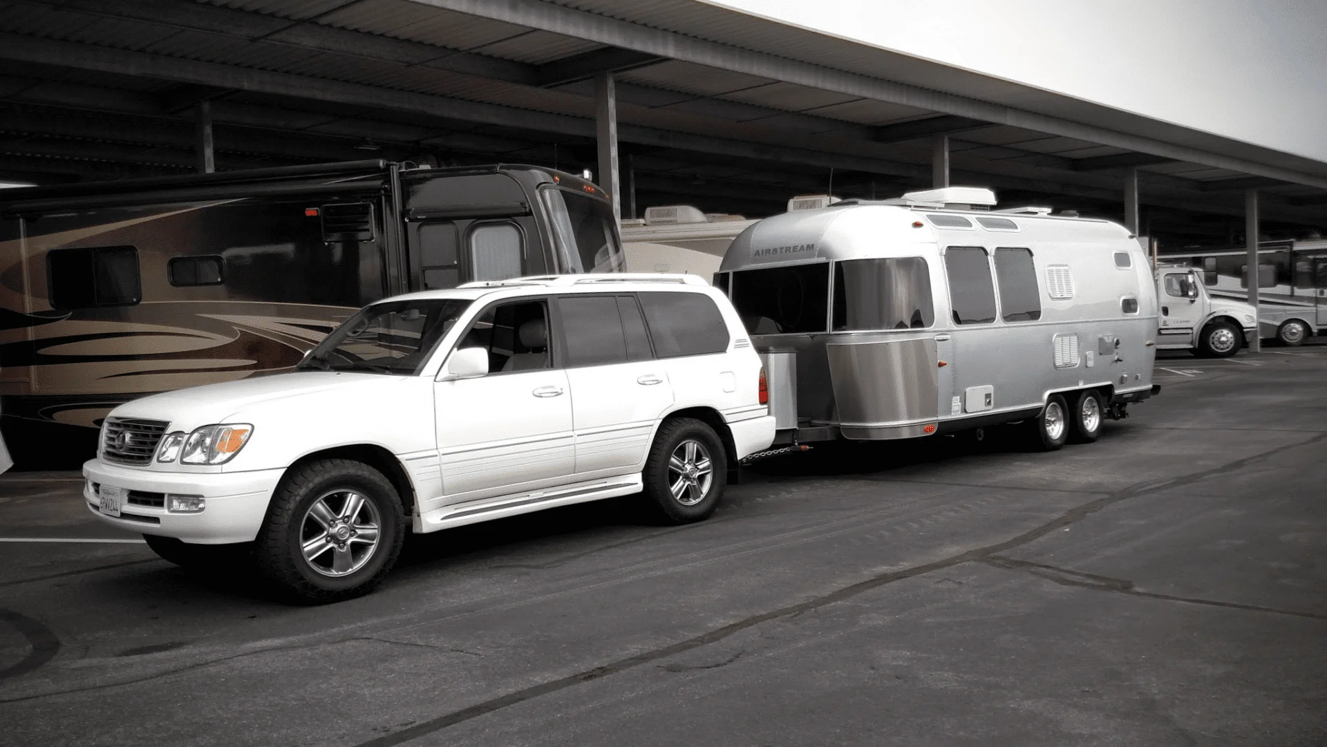

Here's my previous '06 100-series on 33s towing what I believe you'd like to tow. Airstream 23D.
She'll do the job and have good stability. As you have an '04, you wont' have the benefit of VVTi which is a significant boost. Grades will be labored in the slow lane. Passing...probably not.

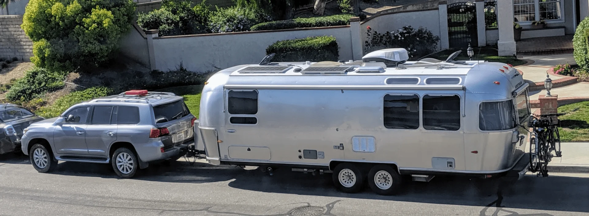

I specifically upgraded to a 200-series as I knew I was going to get a larger widebody Airstream. There's really no comparison when it comes to towing. The 5.7L in the 200-series is a brute with power to spare. I'd highly encourage you to step into a 200-series. Even the earliest 08 models are solid and will tow well. The 16+ with 8-speeds do have a wider spread of gearing for extreme mountain grades, but I find the 6-speed fine even with my 33s and larger Airstream.

Great feedback...thank you!
Would be towing a 23FB Airstream so it's good to know it's possible in the 100, just labored. When upgrading to a 200, I won't have to rush as the 100 will still get the job done until that happens. I am running 33s, sliders, and Dissent bumper so have a little extra weight as well.
Great looking AS you have there!
