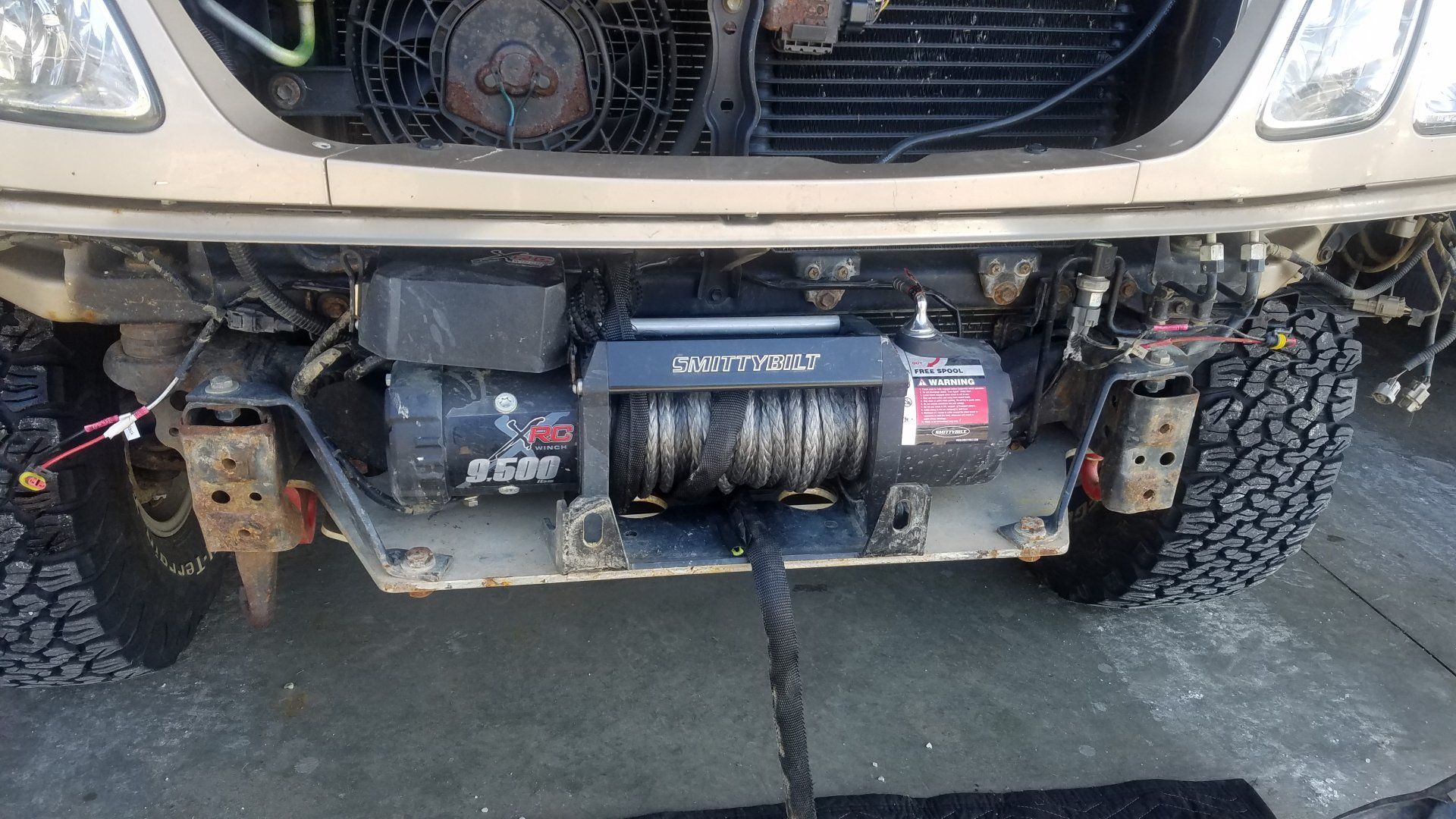

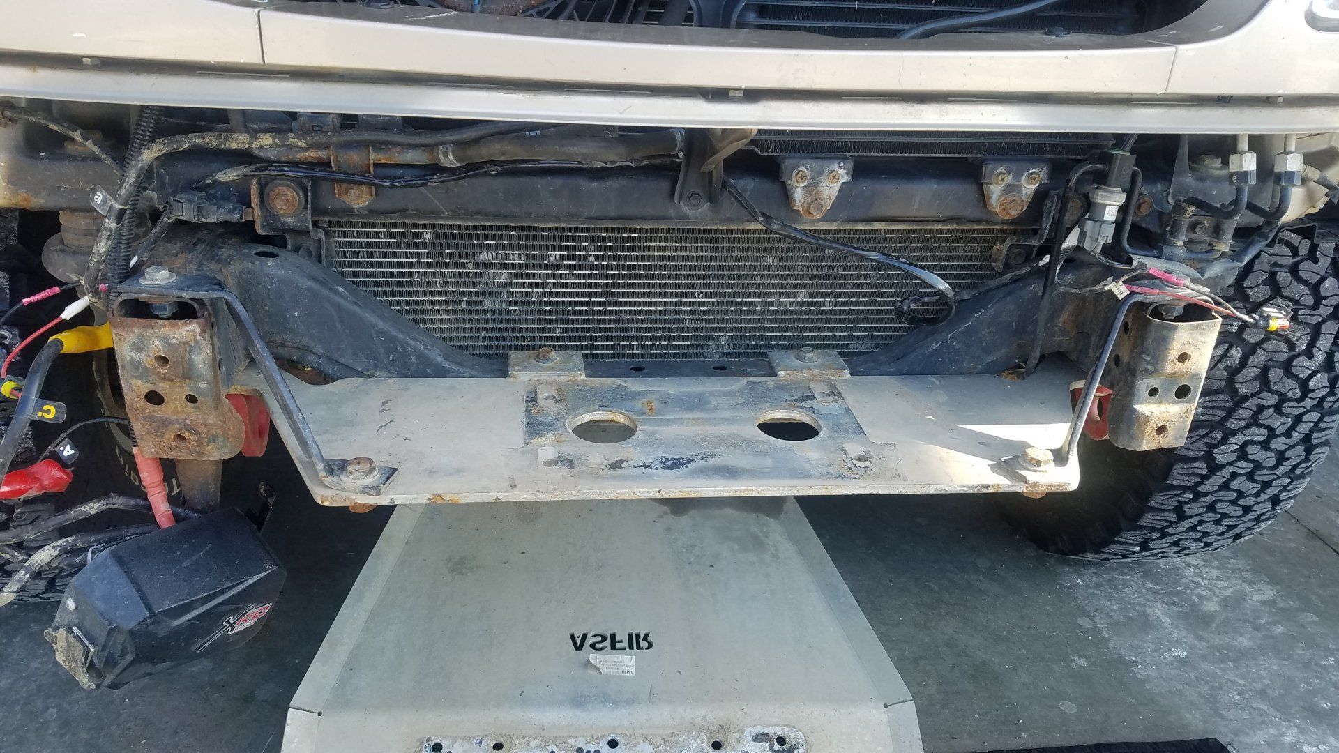

Having said that - A few of us have run the TJM winch mount under the stock bumper with absolutely no-issues. It is beefy and have pulled my heavy ass up some steep hills over some large rocks. Here's what mine looked like (I bought it second hand from another member here!)
I am happy to send you more pictures or any other info if you like.

This looks similar to "TJM 957MTT1781ZDS"
The tabs on the rear look bigger on yours than the ones from the photos of the model number above.
Also, the vertical brackets don't appear in their photos....I'm wondering if it's the same model...there's also no front lip on yours.
I'm gonna put in a call to TJM. I'm sure TT is very well built, but I can't justify spending over twice as much when there is possibly another alternative.
Edit: Thank you for the photos!

There was an extra plate that bolted in place between the main plate and the winch (the black plate) that had holes for mounting the fairlead (or Hawse lead).
That exact setup, except probably metal line is what I'd like to go with.
Is that the TJM mount you bought?

It looks very similar except mine also came with the two twisted metal bars that went from the "horn" of the frame rails to the front edge of the mounting plate.
Where was the fairlead in relation to the front bumper cover?
I had to cut the middle part of the steel bumper support bar behind the plastic cover and then cut a hole in the plastic cover for the fairlead.
