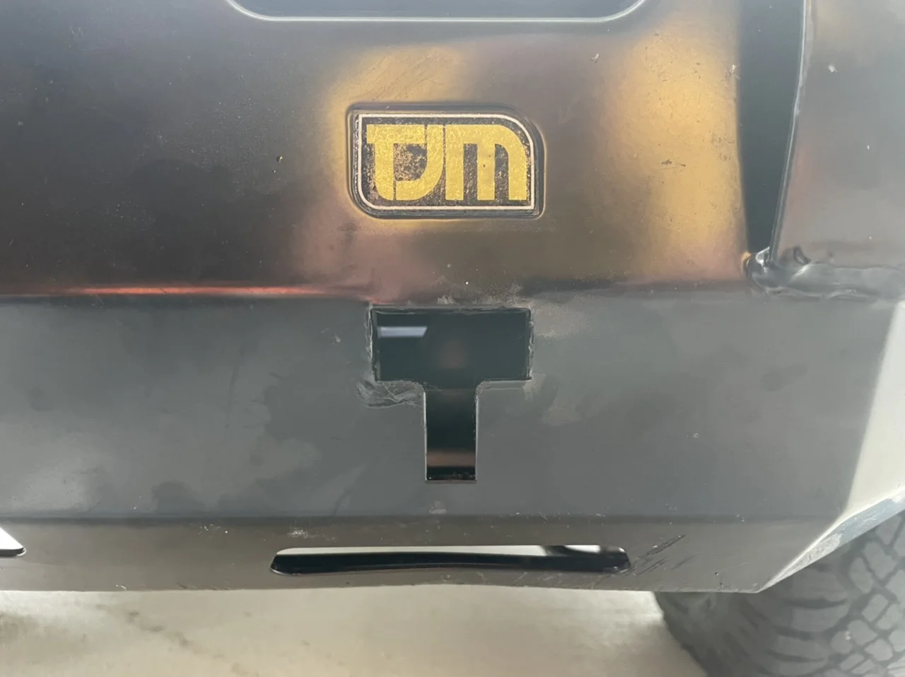

Update: I cut the T-slots in the bumper to fit a regular Hi-lift with a Dremel. Works great. The nose of the hi-lift is very secure in the T-slot it can’t slip off or go side ways. There is also reinforcing steel behind the T-slots made for this. If you have a TJM bumper, I recommend doing this.
