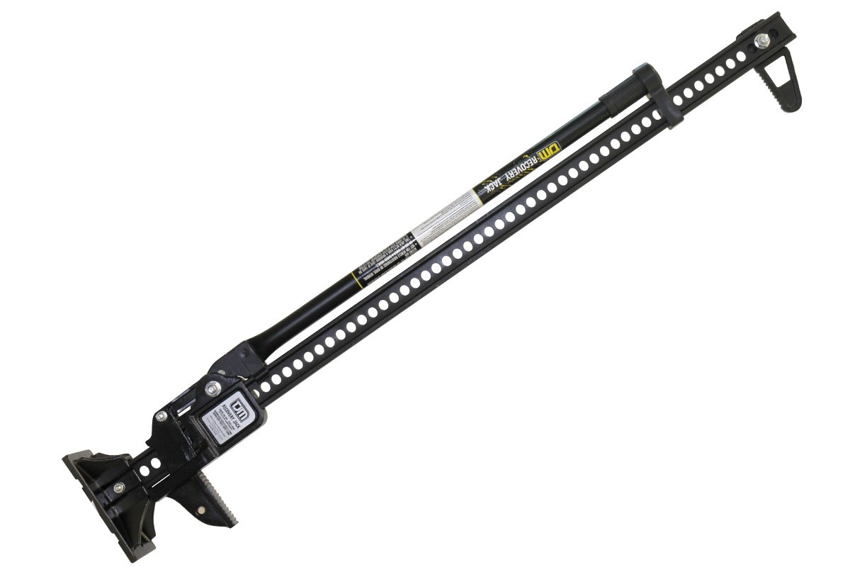

I think I just found my answer #@$%!
seems to be out of stock at TJMUSA. Even if you could find one, its only rated for 1000 kG (2200 lbs). I'm thinking about taking a grinder to the TJM slots....
Now why would they do that? makes little sense..
1000kg is not worth it.. the hi-lift is 7k for the shear pin..
i'd enlarge the holes as needed....
but this also takes the T13 off my list of bumper possibilities.. ARB's fits just fine or at least the one i tried did..
1 have to have a good hi-lift location on the front.

TJM makes their own Hi Lift type jack, maybe it is for that?
Yep:
"This jack fits directly into our unique bull bar T-slot recovery point which has been extensively tested and can be found on many of our steel bull bars."
Yep:
Yes, I found this too but it doesn't look like it is really available or at least easily available. I have a "quote" request in to TJM for it just to see. As I noted above, it is only rated for 1000 kg which would be very close to what a front corner would weigh. Its the "rated" capacity so I'm sure it would work (i.e. it can probably theoretically do double that) but the Hi-Lift is "rated" for 5000 lb (2300 kg) with a 7000 lb shear pin. It would be interesting to know the weight difference between the TJM and a 48" Hi-lift as most of the time you are just lugging it around. For me, I'm going down the path of figuring out how to use my Hi-Lift on it rather than getting the TJM jack.
