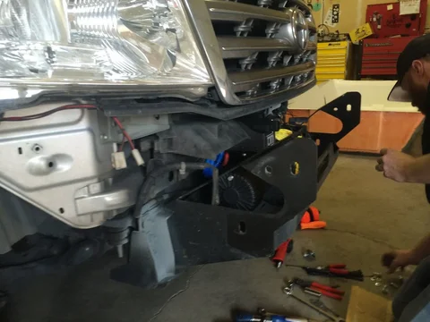

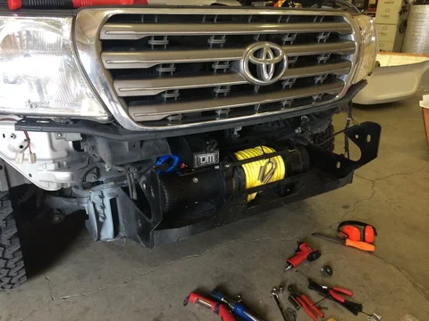

Here are some pics of the install with a TJM winch install. The cradle goes in first, then the winch, then you bolt the bumper on the cradle via 4 bolts. Make sure to use 1/2 inch plywood to make your gapping large enough and uniform when you do the install. Once everything is on tight, drill an extra hole on either side (you can see the hole I drilled in image two between the two slotted holes) as an added reinforcement. You have to supply the last two bolts... I made mine the same size as the bolts that came with the bumper.
