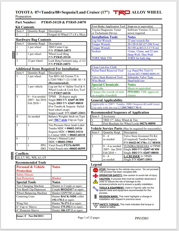

A minor point, but in 2012 when I purchased my 2013 LC200, I also purchased the "17" TRD Alloy Wheel" (aka Rock Warriors) as a dealer option. These wheels were available for the Tundra, Sequoia and Land Cruiser - here's the "poop sheet" from Toyota:
Find the full document here: Toyota Installation Sheet for 17" TRD Alloy Wheels
It is reasonable to assume that Toyota fully tested the compatibility and suitability of these wheels on all 3 platforms.

Yep. Good call. This is the first time I’ve seen documentation of rock warriors being installed on a land cruiser in the United States. I always assumed it was an overseas option.
Thanks for sharing.

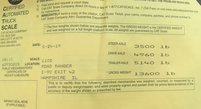

Nice… im interested in weighing my LX too… it might change my mind on some things… but we’ll see.
thx for sharing your weight. Safe to assume thats fully loaded?
Fully loaded with a fully loaded trailer which IIRC also had some water in the tanks. Somewhere around here I posted the info with that weigh in but I was a family of 5, dog, cooler, and kayaks in the truck, and then about 920# of trailer tongue weight
