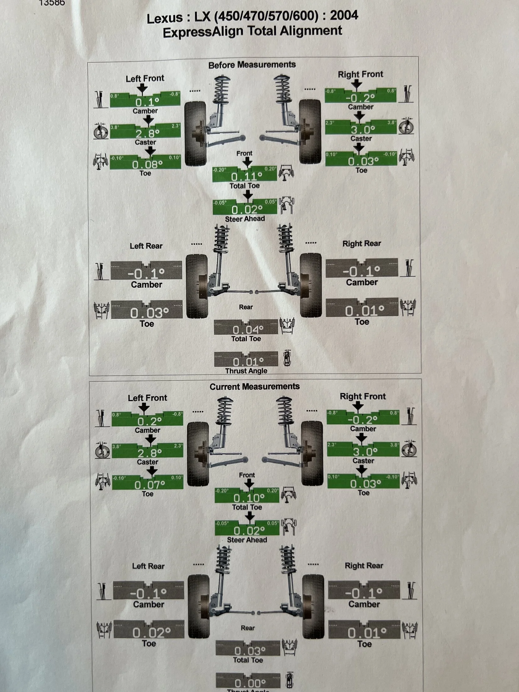

Digging up this thread in hopes of finding a solution to the same problem. I have a 2004 LX with about a 1/2” AHC sensor lift. I’ve replaced the following and also had Lexus perform an alignment with everything in spec. Drives fine, but both fronts wear pretty fast on the outer edge.
  • OEM Upper control arms (with bushings/ball joints
  • OEM lower bushings
  • 555 lower ball joints
Still headed home in a long road trip and will dig into this more when I get home, but let’s argue a theory. Would a slow bleed/leak of rear AHC, resulting in a ~1/2” rear height drop cause enough of a tow-in increase (in the front) to dramatically increase outer tire wear in the front?
I’m skeptical of my own theory since toe shouldn’t change if the front remains at the same height. But…tires seem to be more worn than they were at the beginning of this 2k mile trip.
Latest alignment.
