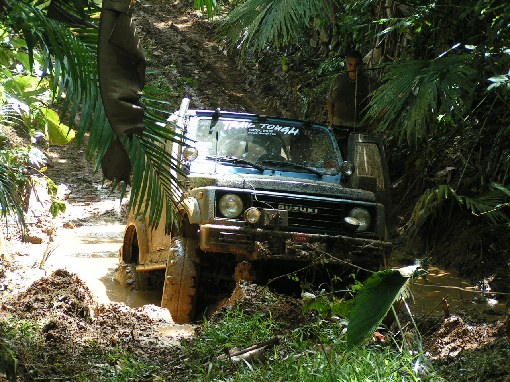

Here is a pic. of my buddies zuk. Tis a sweet rig, but its more of a crawler.
Not a mudder. WEH8MUD!
Cheers,
Nick
And that mud is thick.
