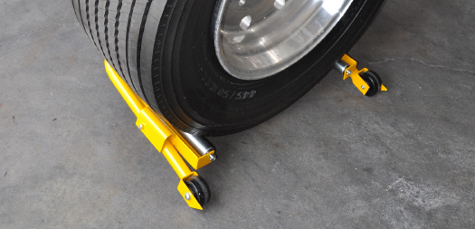

Here's an idea:
I think he uses this: 1250 lb. Capacity Vehicle Positioning Wheel Dolly - https://www.harborfreight.com/automotive/jacks-jack-stands/vehicle-dollies/1250-lb-capacity-vehicle-positioning-wheel-dolly-61917.html
Something else I'm tempted to try (since I already own one) is to use a Harbor Freight transmission dolly.

Yep, I manhandle them as well, and usually by the 4th one I'm using the cradle method. About 4 months ago I herniated a disc in my back, so now I am trying to be cautious which is causing me to change the way I do some things. Thanks for the link, was thinking of something like that.
What I would really like is just the alignment pins that fit our lugs. With two of them threaded on, it would be cake.

:edit: ooh, that wheel dolly thing looks pretty clever.

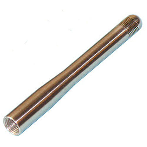

Yes, like that but M14 x 1.5 I believe. Would be a simple solution. I like the tire lift/dolly too, but the drift pins require a lot less room to store!
If M14 x 1.5 is correct, how about these?
Link: Wheelez Lug Guide Tool
HTH

Bottom line goal of my post, first to find some alignment drift pins which seem like would eliminate 2 or 3 takes of lining it up, thanks @gaijin those are it, second was to make the process easier on my beat to crap back. The wheel dolly seems to be the answer for that. Going to start with the drift pins and go from there. Or get that girl to come over and line em up for me.
