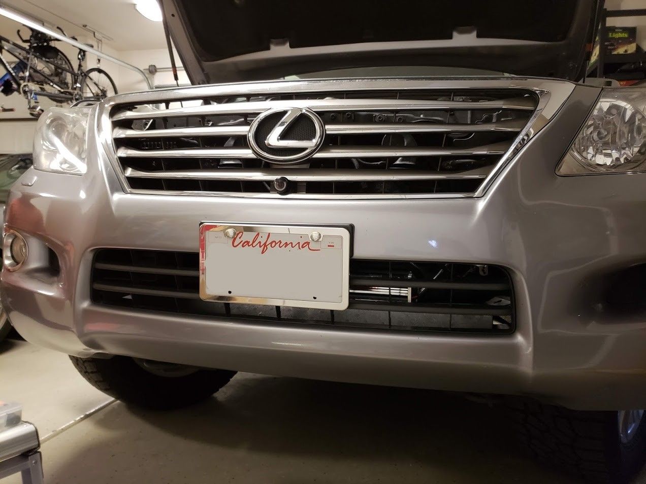

My OBA is pretty basic with install documented here
I use a standard manual inflator and hose. Both of which fit great where the jack is to the side. I put the inflator in first pretty deep in the cavity. Then coil the air hose in large loops so the first aid kid fits within the coil.

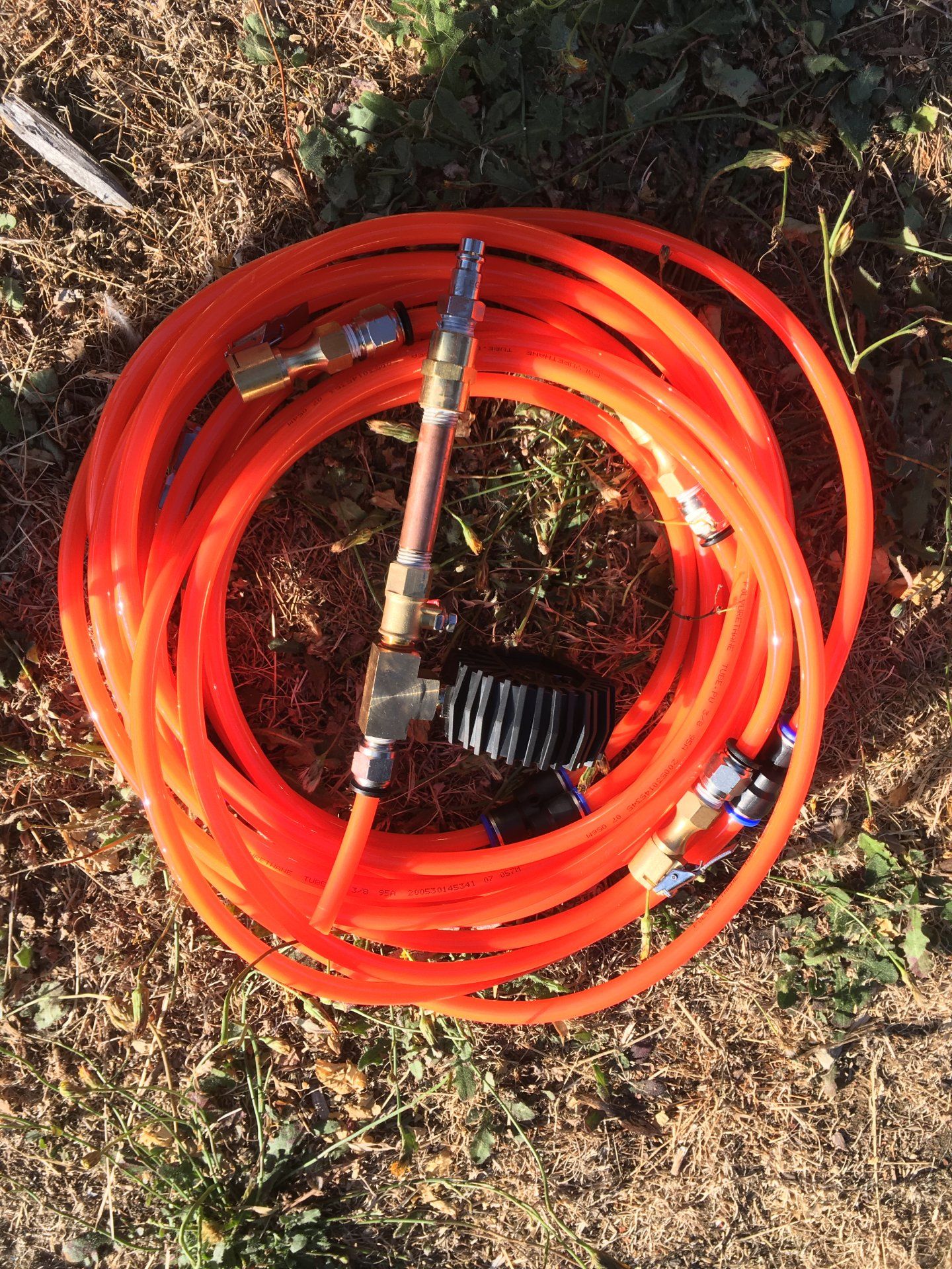

Homemade 4 tire inflator. Cost about $100. Very easy to make using push to connect tubing. Takes less space than my old 25 ft single hose. The chucks are closed, so works for any number of tires zero to 4. Also works for stand up paddle board and bicycle tires. It sounds and looks fiddly, but definitely faster than one tire at a time. Lots of redundancy as well, if you care about that.

I thought the MORRFlate was a little overpriced and I had an Amazon gift card so I decided to go the DIY route. I'm happy with my end result but no longer think the Morrflate is overpriced. I spent a little over $300. I wasn't satisfied with a few cheaper parts I originally tried like the barbed tees and 4-way threaded tee. I ended up going overkill on my connections. It is all field serviceable and modular.

Short whip to connect to my compressor:
One half. I really like the clean look with this threaded stainless steel tee:
The bag I already had:
Cheaper parts I ended up not using:

I have the Morflate as well and I really like it. It is expensive, but like @g1701gst I started pricing out components and factoring in my time and decided that it may not save much in the end. I really like the Flexzilla components. Nothing cheap there.
I used the same materials as @grinchy for running my plumbing in the truck (ie from the engine bay to the tailgate where my quick connect is) and that has worked out great. The only thing I would be concerned about with using it in a 4-way kit is that I find that I am pretty rough on the morflate. I am tossing it around the swingouts and occasionally tripping on it and it is constantly in mud, dirt, and rock. I wonder how those compression fittings will hold up in the long run.
I made my own based on instruction here too. I don't think I saved much over the morflate, but they had long lead times when I was looking. I also used flexzilla hose and components and it is good stuff. Only bummer is that digital guage shuts off mid inflation and you have to wake it up.
