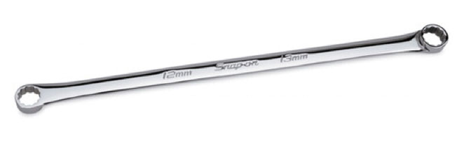

Last time I removed/installed the stud nuts on my fan I must have dropped my wrench and the nuts several times. I remember using a long handled open wrench and a magnet tool to try and catch them. Obviously you can't get a socket on them because the fan is in the way. Hard to get them started going back on because you can't get your hands down in there.
I do remember using the very tip of the wrench to kinda spin the nuts to get them started. Also trying to hold them with the magnet tool while trying turn them. PITA!
So if you are able to use the box end (I would have to look at mine) what I have done with other hard to reach nuts is to put a piece of electrical tape on one side of the box end. Even if the bolt is pointing out, there should still be enough stickiness to hold the nut.

Save yourself some grief and use the mother of all fan clutch nut wrenches.
Fan Clutch Removal -- Do I remove these nuts?
This wrench (after taking a file to it) makes removing the fan easy and fun. Replace the nuts after you remove them with new Toyota nuts.
When replacing the nuts, loosen the fan belt to spin the pulley so you can get at the stud, then I carefully start the nut in the stud holding it between a finger on each hand. Then the rest is easy. That wrench makes tightening the nuts super easy cuz you've got a lot of leverage — SO DONT OVER TIGHTEN THEM --- otherwise you may not get them off the next time.

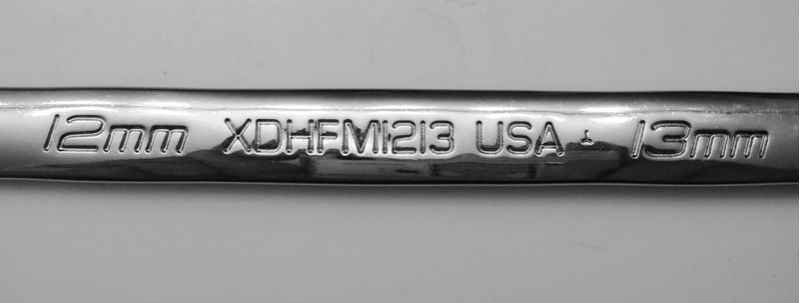

Agree on the long box end 12mm. One thought is to split the fan shroud while your in there.

5. I didn't have a long box wrench today so I used the open end of a ratchet wrench. It was easily an inch longer than a stock craftsman or kobalt wrench and that one inch is a LOT of help getting at these nuts.
