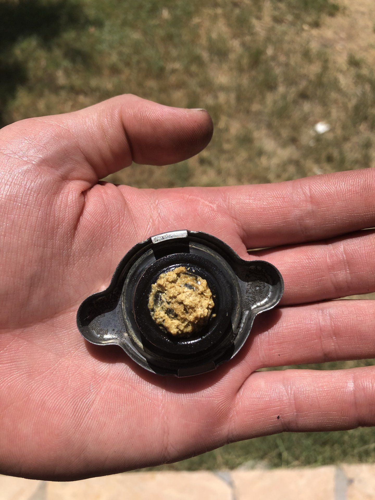

In addition to rust inside the block, I had this nastiness in my coolant system when I first bought my 100. This is what happens when green and red are mixed.

That looks a lot like my gunk - if not a bit softer. When you flushed water through, where'd your push water in and where'd you let it come out?
