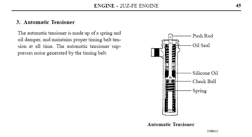

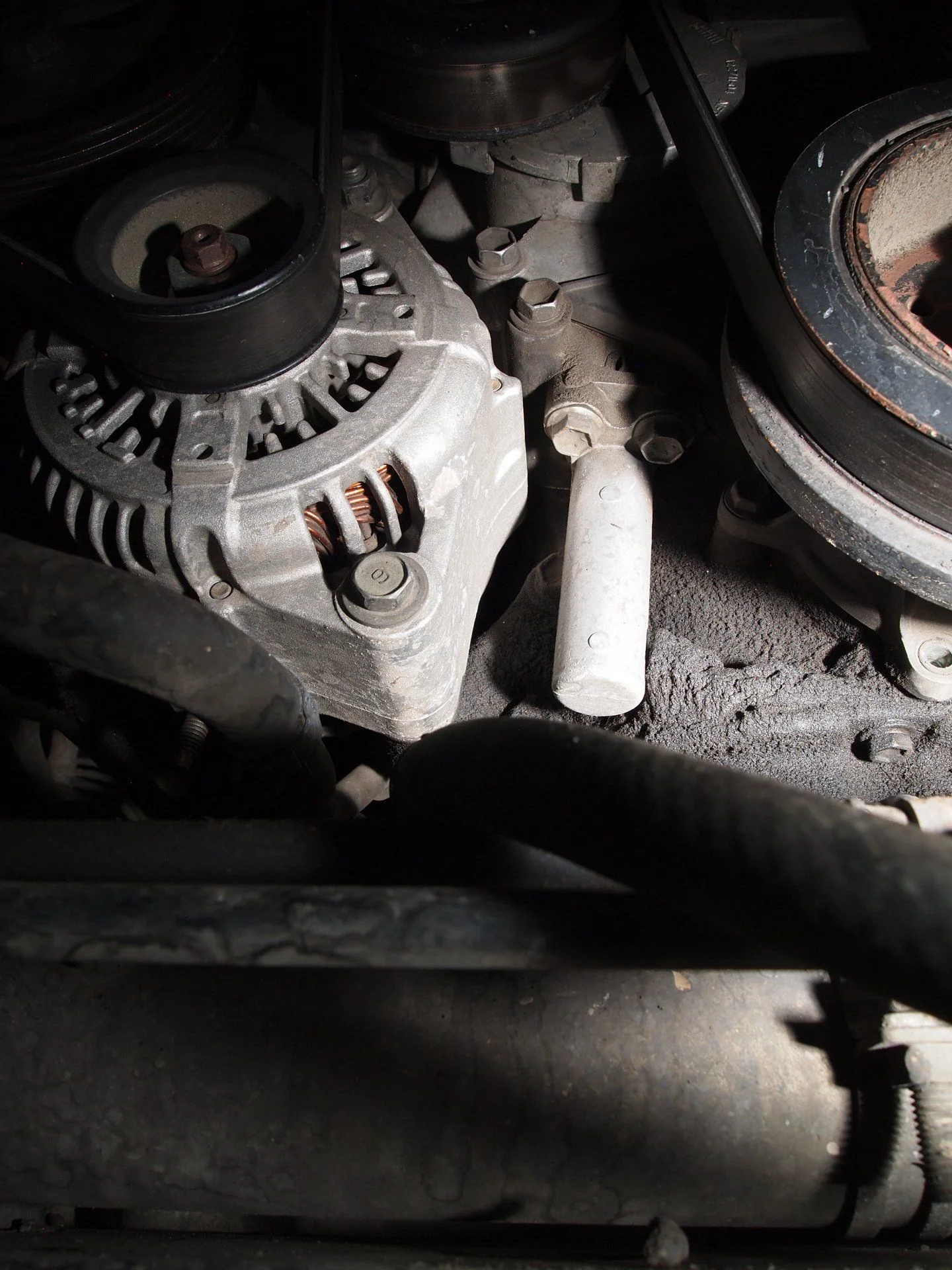

My timing jumped on my 02 LX for the second time in two years. This is my third timing belt in that same time period. The last time it jumped three teeth and the whole left bank quit firing. I believe it did the same thing this time. My mechanic replaced the belt, tensioner, and oil pump believing that the problem is coming from low oil pressure. Has anyone else has this issue?
