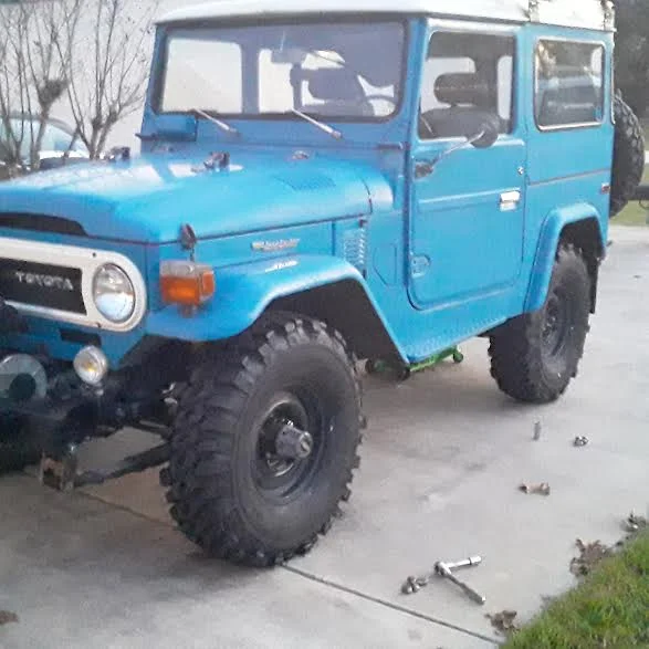

Interco LTB 34x10.5/15
Those are really knoby. They look pretty good though. I'll check them out.
