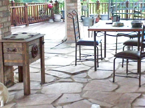

I had a plain concrete patio 2 years ago. I shot a crappy cell pic. I used flagstone and plain mortar and did this.....
I have been very happy with it (and the deck we did later).
No cracking. Holding up fine. However, the winters here are very mild with not many days below freezing and no days below zero.
That's exactly what I want to do.
