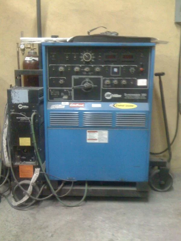

I was in the same position las year, and after some research I concluded that I should get a miller with some options like post flow, pulse, AC balance and a pedal, this will come in handy as my technic progresses, do some reaserch and do not buy the smallest welder you think you need, buy something bigger and buy only once.
The modern inverter machines were aut of my budget so i got a used Miller Syncrowave 300 for $1600.00, these are older models built to last and the technicians at my local welding supply tell me that there is plenty of support in case in needs fixing.
Also check if your electrical installation can handle the demand of current and if not are you willing to pay for an upgrade?
This is what my $1600.00 got me:p
Here Is The Pic.
Forgot to upload piture in previous post
