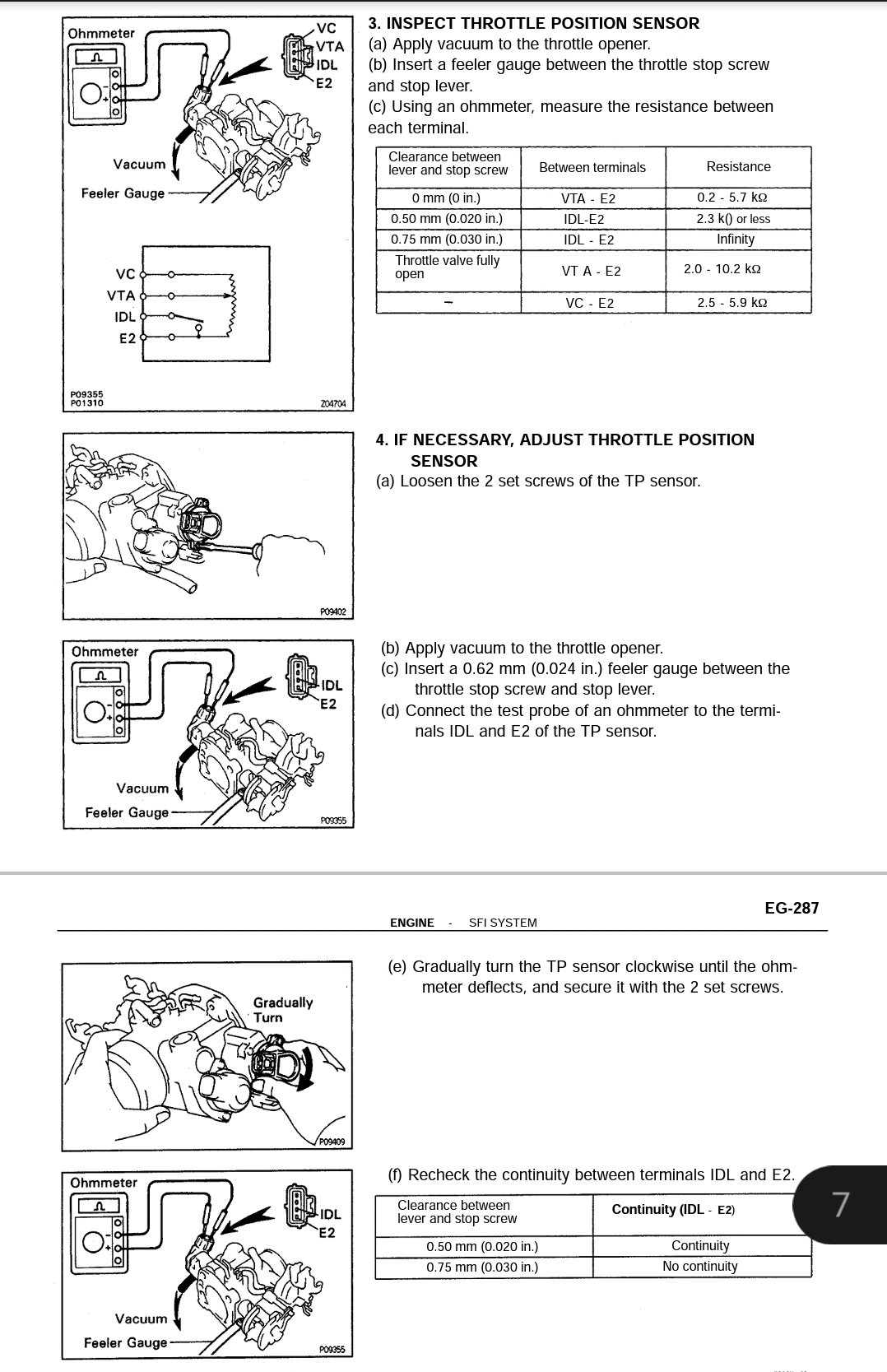

From the 94 FSM:
It's not hard. However, if you muck it up, it won't run right.
Maybe just give the new owner the part, have the code cleared at the local FLAPS and let the new owner deal with it?
You're supposed to use an analog multimeter, connect it to a couple of pins on the TPS connector, and stick a feeler gauge into the throttle dashpot, then rotate the TPS until the multimeter needle deflects. Plus, you need to be sucking on a hose while doing it.
Or you can just eyeball it and try to get it about where the old one was. This worked for me for awhile, but it seemed to cause a slight hesitation when pulling out of my driveway on a cold engine. Following the FSM instructions got rid of the hesitation.

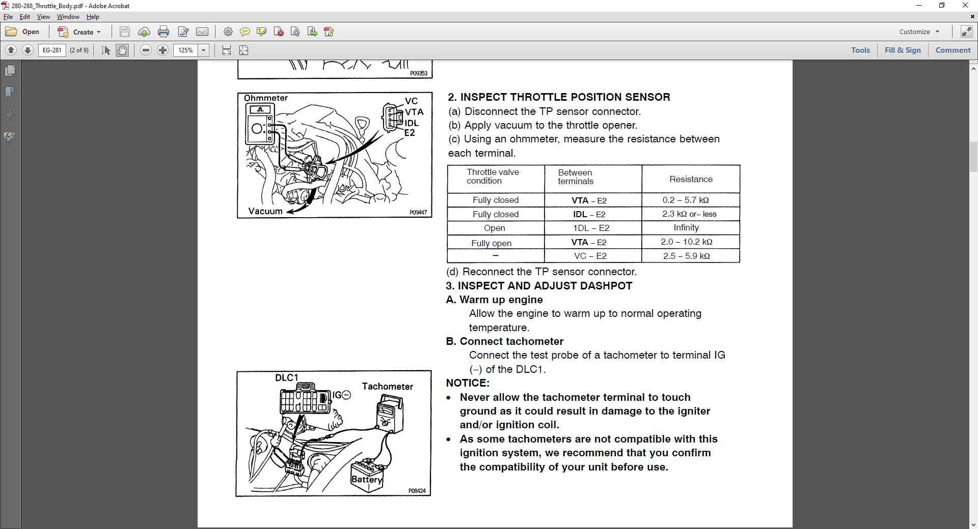

The adjustment procedure is a page or two past what @BILT4ME posted.

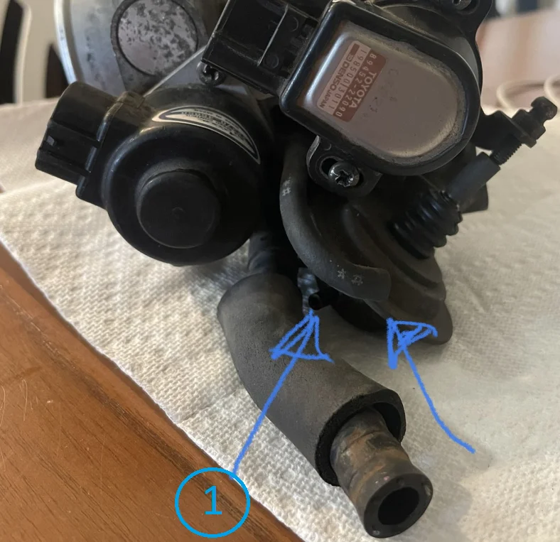

Hi, is the spot 1 in the photo where I apply vacuum? Thanks.
Yes, this is where vacuum needs to be applied. It pulls the actuator away from the set screw. I have no idea what the function of this vacuum device is.
