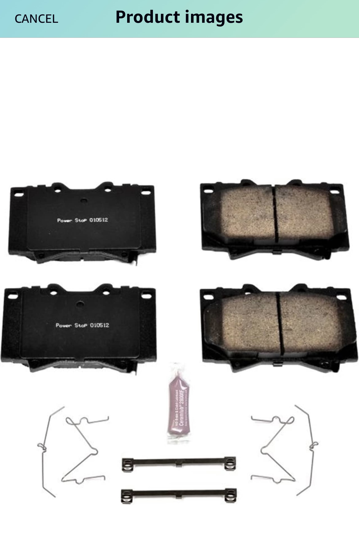

After installing new front OE pads, after couple weeks, I started to hear periodic squeals and sometimes grinding noise when in slow roll at at stop light. The grind noise sounded like it was skipping some part of rotor as it went full revolution…like if rotor was warped.
It was annoying but not causing any performance issue so I let it ride for many months. So, last month, had some time and suspecting it was the pads and I didn’t “break it in” properly and used old existing hardware, I changed out the OE pads with new aftermarket $50 pads with new hardware.
When changing out the pads, I inspected the rotors via feel and visual and it seemed fine. I also properly broke it in after installing the new pads.
It’s been about 3 weeks or so now and I will say the squeal and grinding noise is gone. So, my experience is it’s the pads and properly breaking it in.
Will go back to OE when this pair wears out.
Amazon: never used it before but this is the brand/product.
