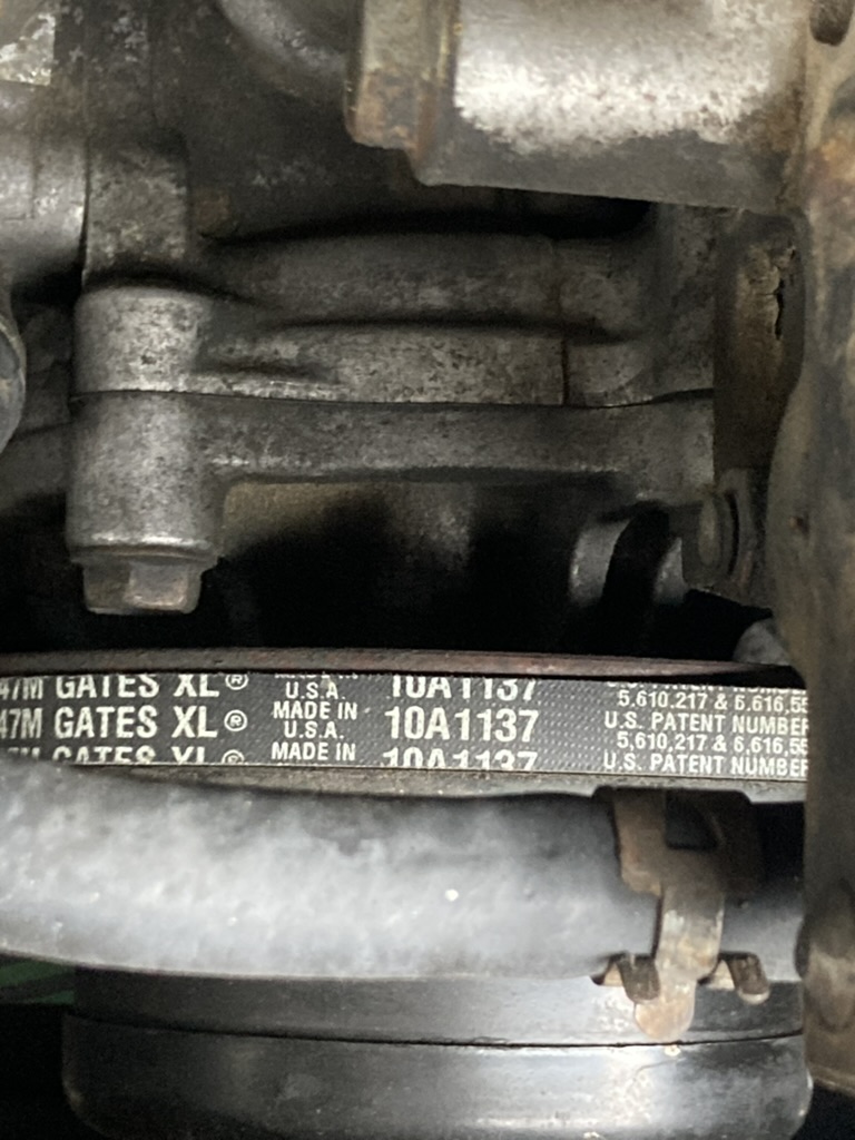

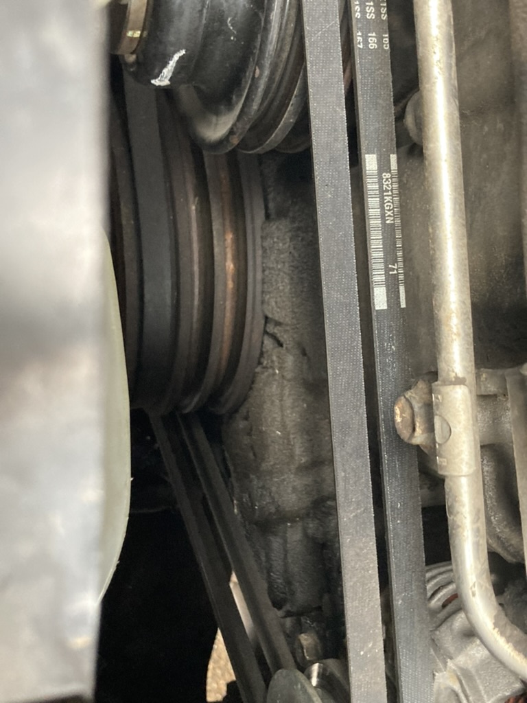

The PO had the drive belts replaced a few years ago along with the radiator. As you can see below, they the Gates brand, made in the US.
I've heard mixed opinions on their quality however. I replaced all my hoses with genuine Toyota rubber, but would it be worth replacing the belts with OEM as well?
They seem to be holding up well, but just thought I'd put this out there. Don't mind the petroleum deposits on my engine block.

Gates belts are good. Just make sure to NOT use the ribbed ones that whine bad on the idler pulley.
I use Gates on all my other vehicles, but I can buy Toyota belts from Toyota for less than I can buy the Gates belts from FLAPS.
The benefit to the Toyota belts, specifically for the alt, is they are a matched set. No variance at all.
Checking mine again today and one is stretching more than the other. Is this the reference people speak of what should not be happening?
^this^ plus often the Toyota belts are cheaper amazingly enough.
Gates is a tier-one supplier. Nothing wrong with them.
That being said, OEM Toyota belts are optimal and VERY reasonably priced. Gates would be my second choice, but only if I could not get real ones when I needed them.
Of course there is a variance, it’s just minimal. That’s why the idler has a wobble to it. It balances the tension.
With todays manufacturing techniques the tolerances are really tight for no other reason than to minimize waste. I’m sure the gates belts are fine and with new design technology possibly better that the factory ones.
Pretty sure the idler is there for WOT/high rpm belt control vs a belt variance wobble. Tho it’s usefulness is negligible IMO.
I just ordered the OEM belts during the parts sale and they were virtually free. I pretty much had to buy them. I'm sure you understand.
I just went out and double checked a brand new idler on one of my trucks and it definitely has a wobble in it. It's hard for me to see that as anything but intentional. But maybe it's a bean counter thing after all.
