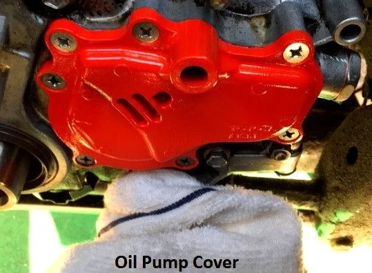

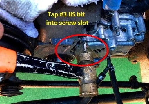

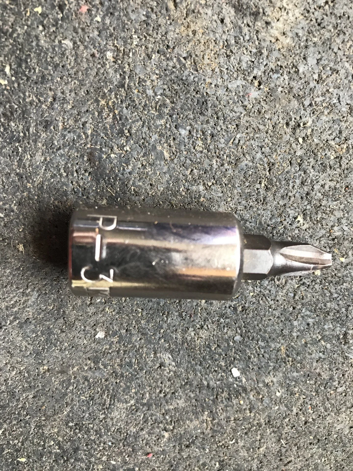

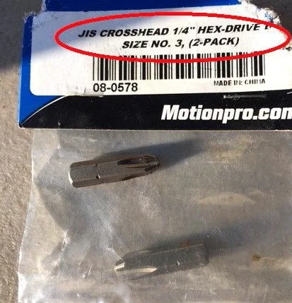

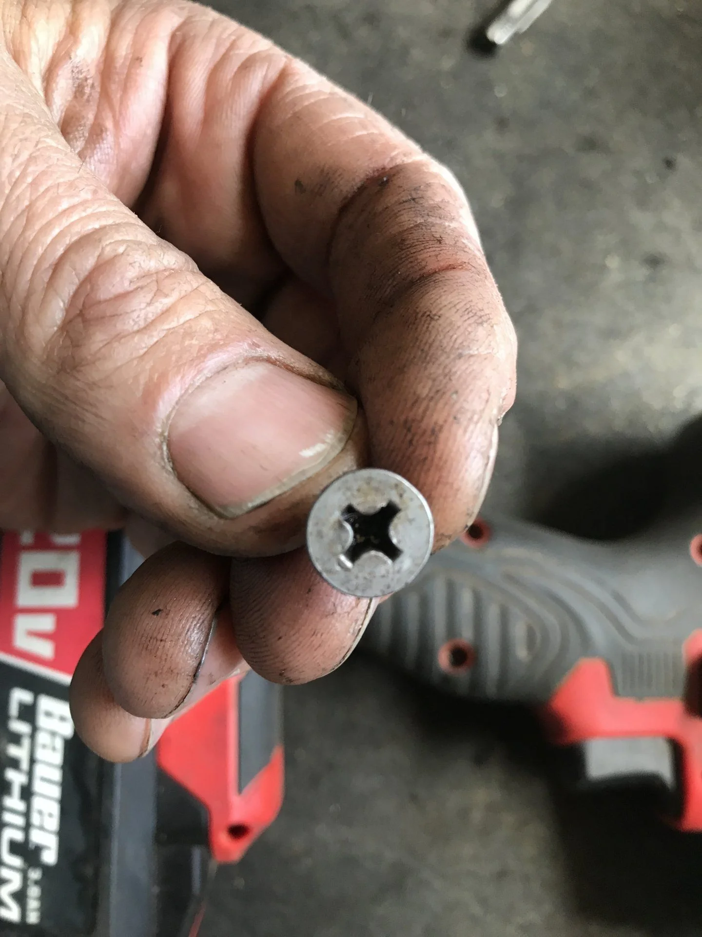

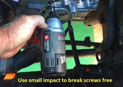

I watched a bunch of videos and read a couple threads but they all seemed risky to me. This is what I used. 3/8” battery impact and a P-3 bit. It took longer to clean the head of the screws than to remove them and no damage to the screws. They should go back the same way. Clean the heads real well, hold the impact straight and just barely pull the trigger, they will break loose on about the 3rd ratchet. You’ll need to remove the radiator but that is less work than monkeying around with buggered up screws. If you don’t have an impact go to China Freight and spend the $60. I’ve had this one for two years and haven’t had to return it yet. Hope this helps

I also tapped the bit into the screw head with a small hammer before putting the impact on it. Very easy job without the rad in the way.

Good luck swinging a hammer in that small space. Impact tools (Air, Corded, Battery) work just fine.

As long as you hammer in a good fitting bit, I like using a ratchet as I can fell it starting to move or deform. I have done multiple and never had an Issue. Look up the thread by Zane and it explains the best bit to use.
