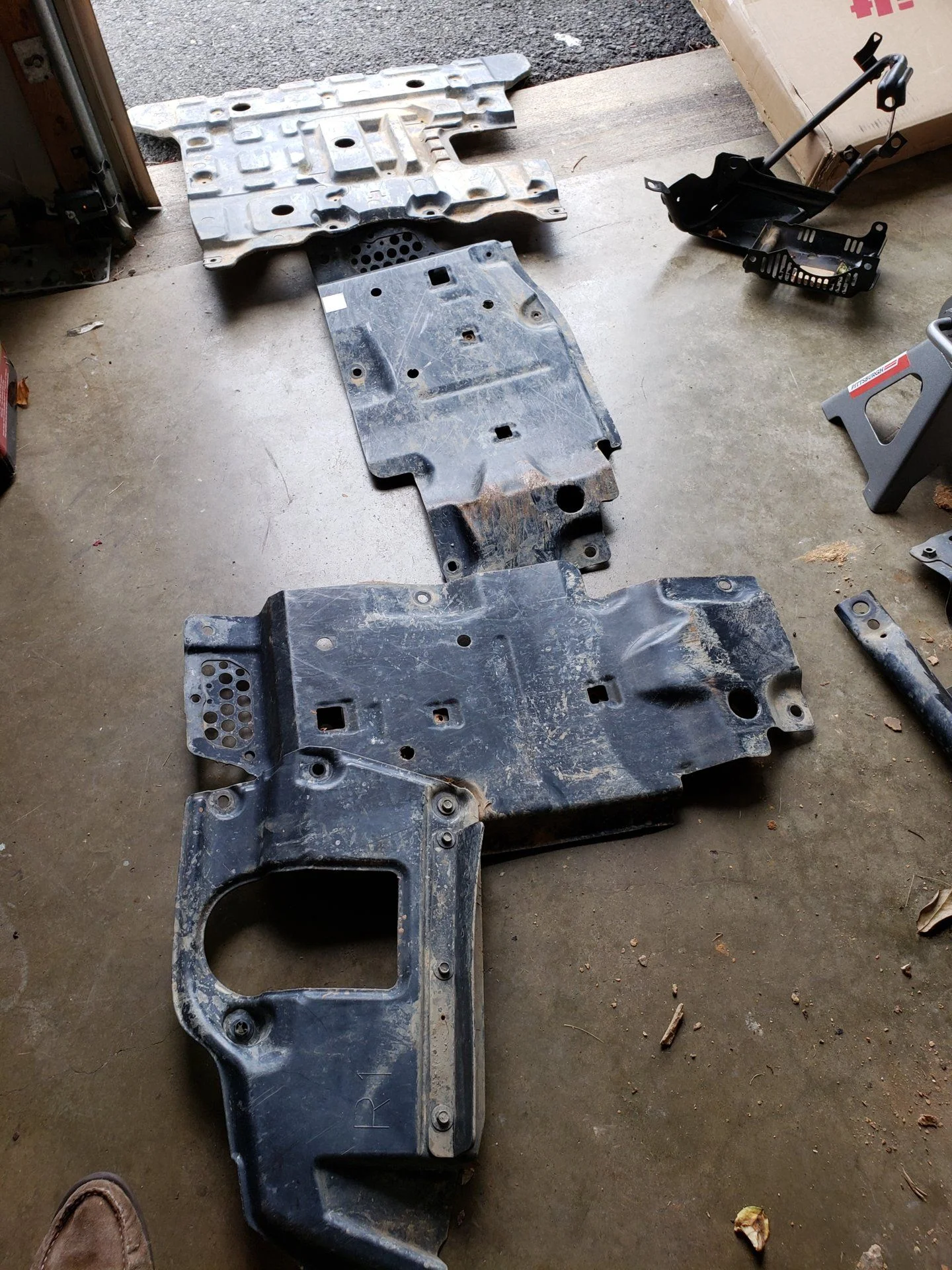

I just removed my BB skids last weekend and had the undercarriage steam-cleaned to get rid of Moab cement. If you're doing the install yourself here are a few tips:
