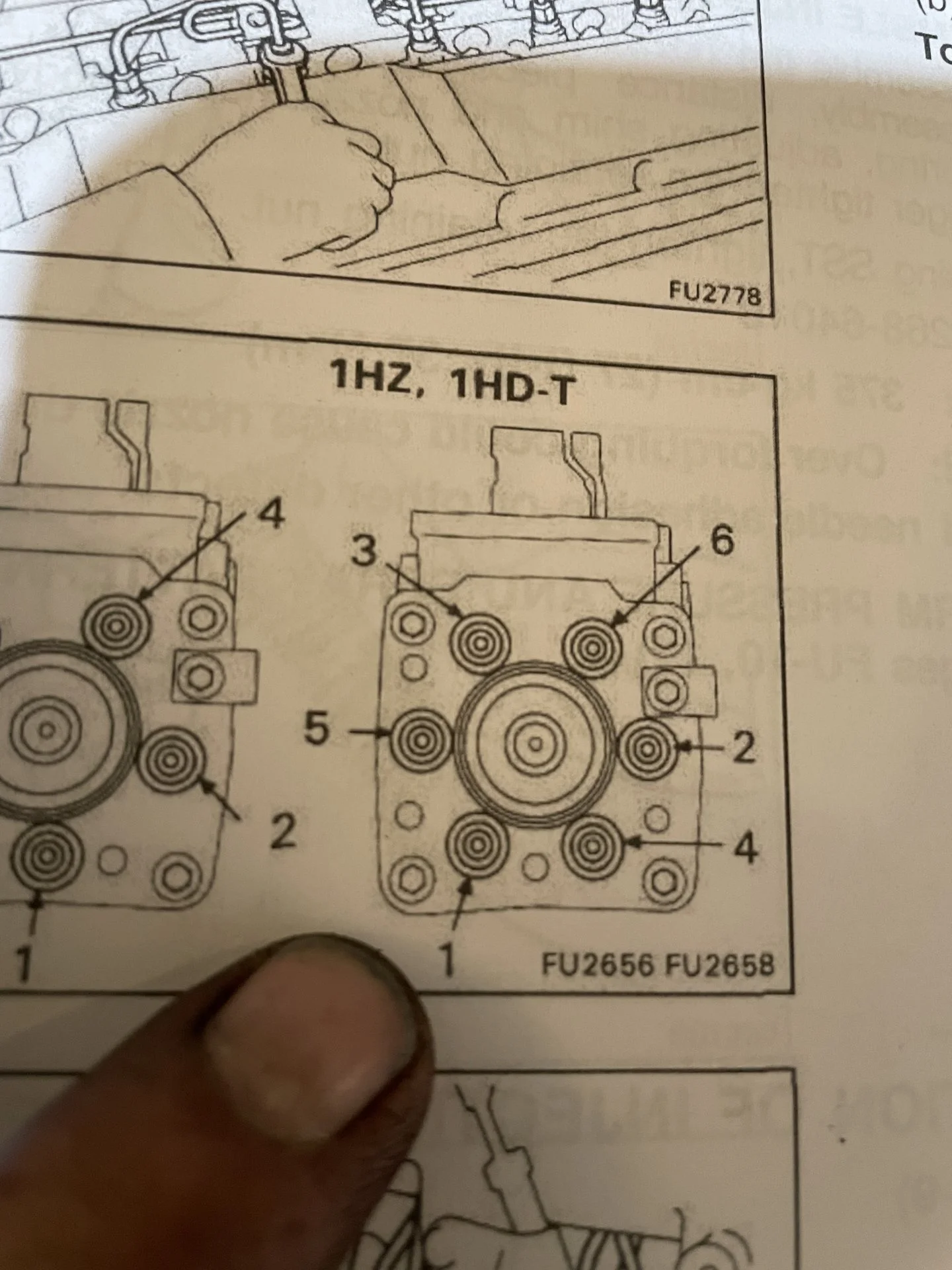

@Onur if you wouldn't mind taking a pic of the injection line routing when you get to that point? I just installed the pump you sold me (i got it rebuilt) and could use a good visual reference again.
Sorry for the late reply. Here you go:
This is an important diagram for understanding routing:
Follow the numbering here.
Headache tip: install #6 before #5.
