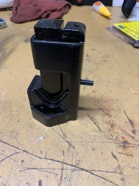

The bench vise worked OK, but made the crimps flat. Then doing the other end when working on the truck impractical

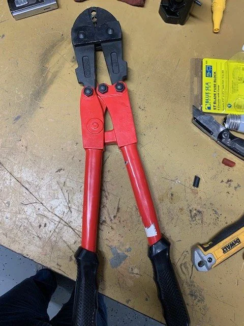

So I bought the hammer crimp. It didnt work for me

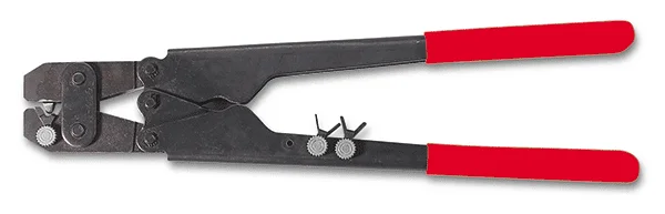

Then I Bought these big handled crimpers and just couldn't get good crimps

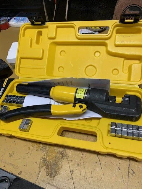

Then I bought this Hydraulic Crimping tool on Amazon and it was a breeze. Nice looking and easy crimps. I highly recommend it

You match the bit to the size wire. You then crank the handle with the wire/connector until the connector doesnt move. Make sure the wire is in good and then pump the handle until you can't
Then turn a little wheel that is on the other side you cant see and it releases the pressure

yup, got the same one. Works a treat (so far). Not the highest quality tool but very inexpensive on amazon for the usefulness. But do check the number and size of the dies that come with your intended purchase, they vary somewhat. And oddly enough, IIRC, the HF version is significantly more expensive than the amazon ones for the same thing apparently.
However, should I have to buy another one, I'd go with the other ubiquitous style, with the 2 parallel slots die holders and the bolt at the end. (More often seen on the "16 tons" units.) I think those have a better design. The dies on my style have a wimpy locator pin that I suspect will shear sooner or later and then the die will likely be useless, whereas the other style AFAIK does not have that pin and you could build any custom die you want very easily for it from a couple bits of steel. Unfortunately for smaller jobs, the included dies start usually bigger with the 16 ton units, but that is fairly easily remedied.

Huh. I have the hammer type and the big bolt-cutter style, and they have been working great for me. Crimp the ring on, melt some solder in, then adhesive-lined heat shrink. Makes really nice crimps, I've gone all the way up to 1/0.

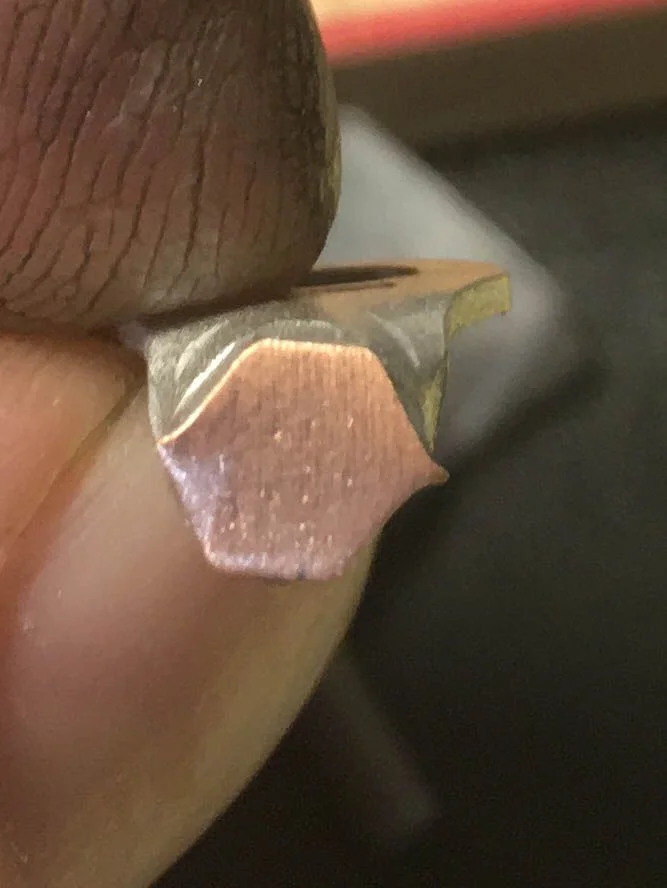

I can't help but think that a (or better: several / wide) nice controlled hex hydraulic crimp is way better than a "crimp" of sorts done by dimpling one side with an impact tool...
There are some interesting reports out there on the effects of various types of crimping on the quality of the connection. The cross-section pics are especially telling.
