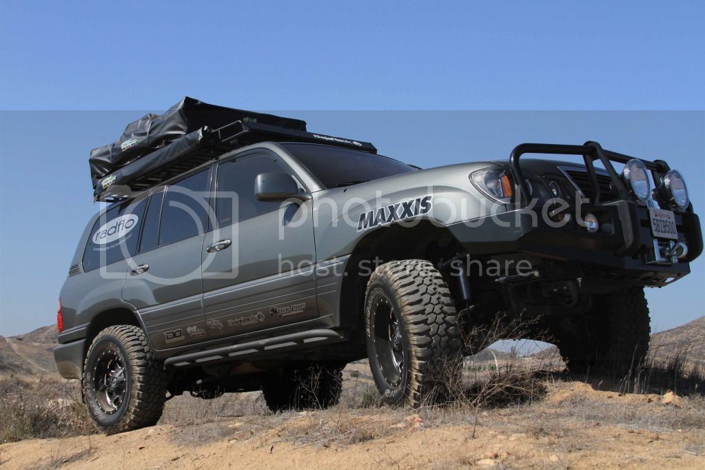

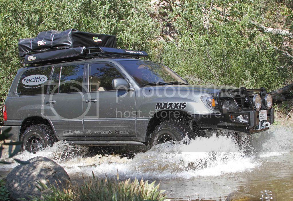

The fine people at Total Chaos and Demello Offroad took the Radflo LX470 out for a photo shoot yesterday. The pics came out great and the vehicle performed flawlessly!!! Thanks to all the companies that helped out in this build. Ironman, Baja Rack, Maxxis Tire, Total Chaos and Demello Offroad.

Absolutely no rubbing on the remotes. I think that has a lot to do with the back spacing of the wheel. What wheels are you running? The tires are 33". Please shoot me an email at mike.crosby@radflo.com and I can send you some fender well pics.

My remotes (2.5") are mounted in the same location. They rubbed at full lock with 285s on stock wheels and no spacers but do not rub with 1" spacers.

My remotes (also 2.5") are mounted in a vertical position as per the way LT @ metaltech instructed and provided the mounting brackets. They RUB at full lock. I had to adjust my bump stops, then i lost one, and I have to now reinstall the turn stop. I plan on bending my bracket that they came with. We'll see what happens.
edit.. stock 18's with 295/65/18 duratracs.
