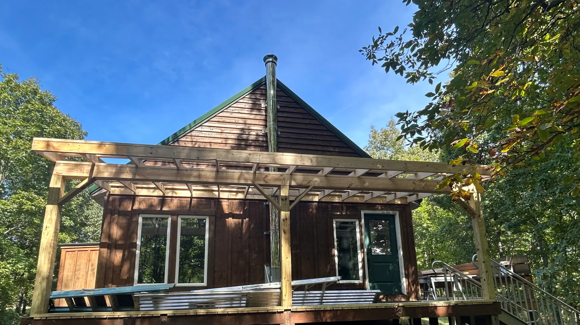

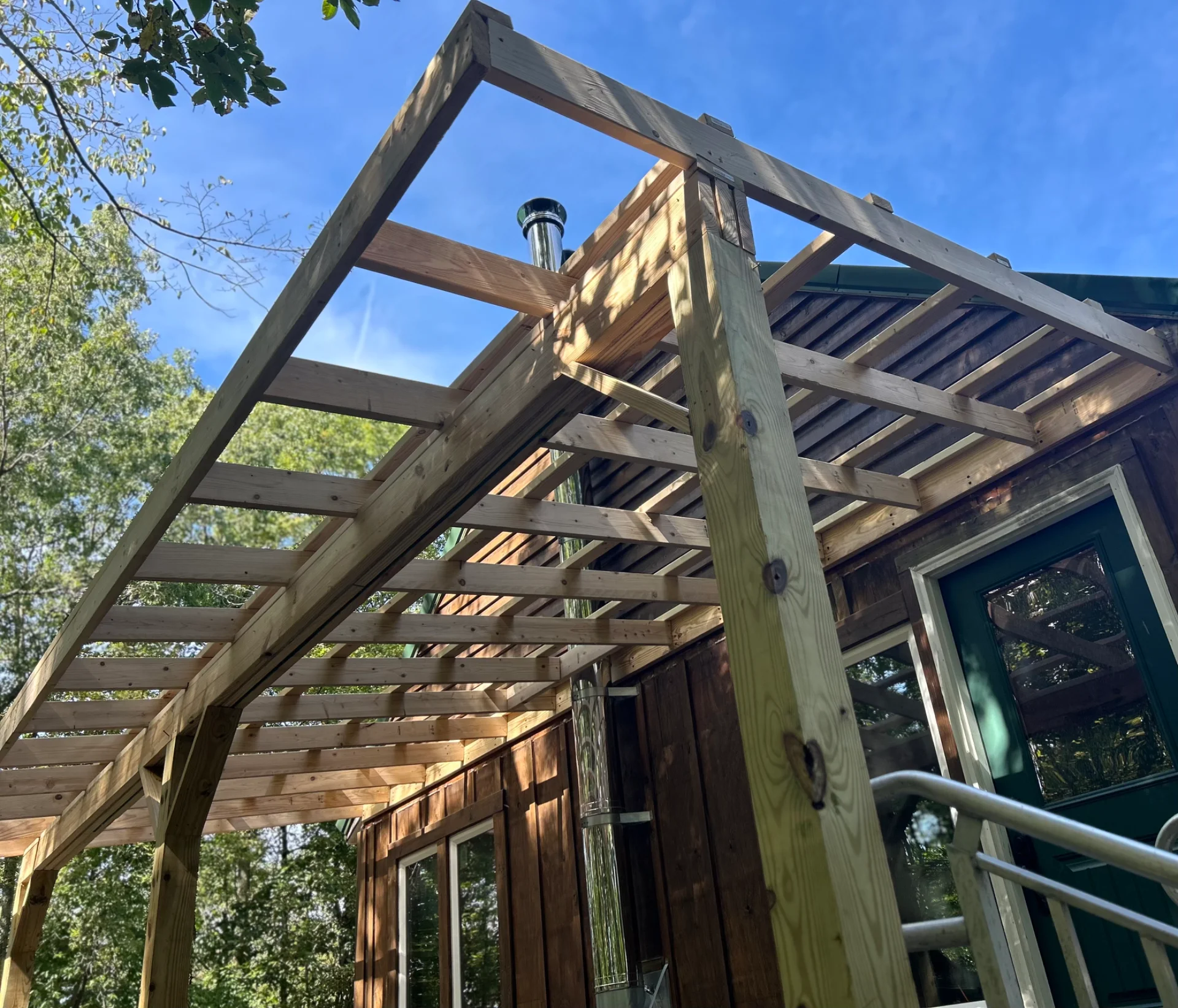

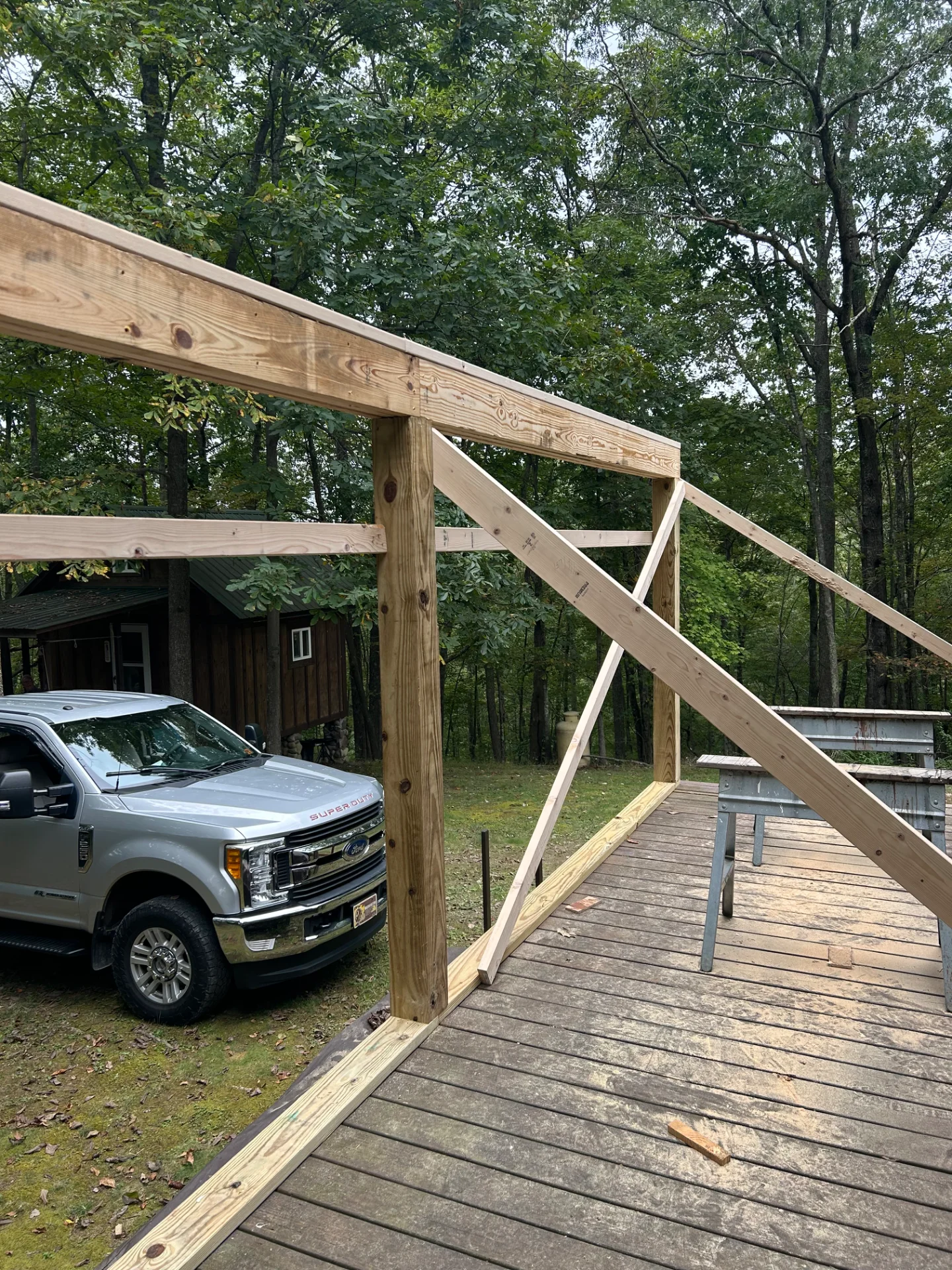

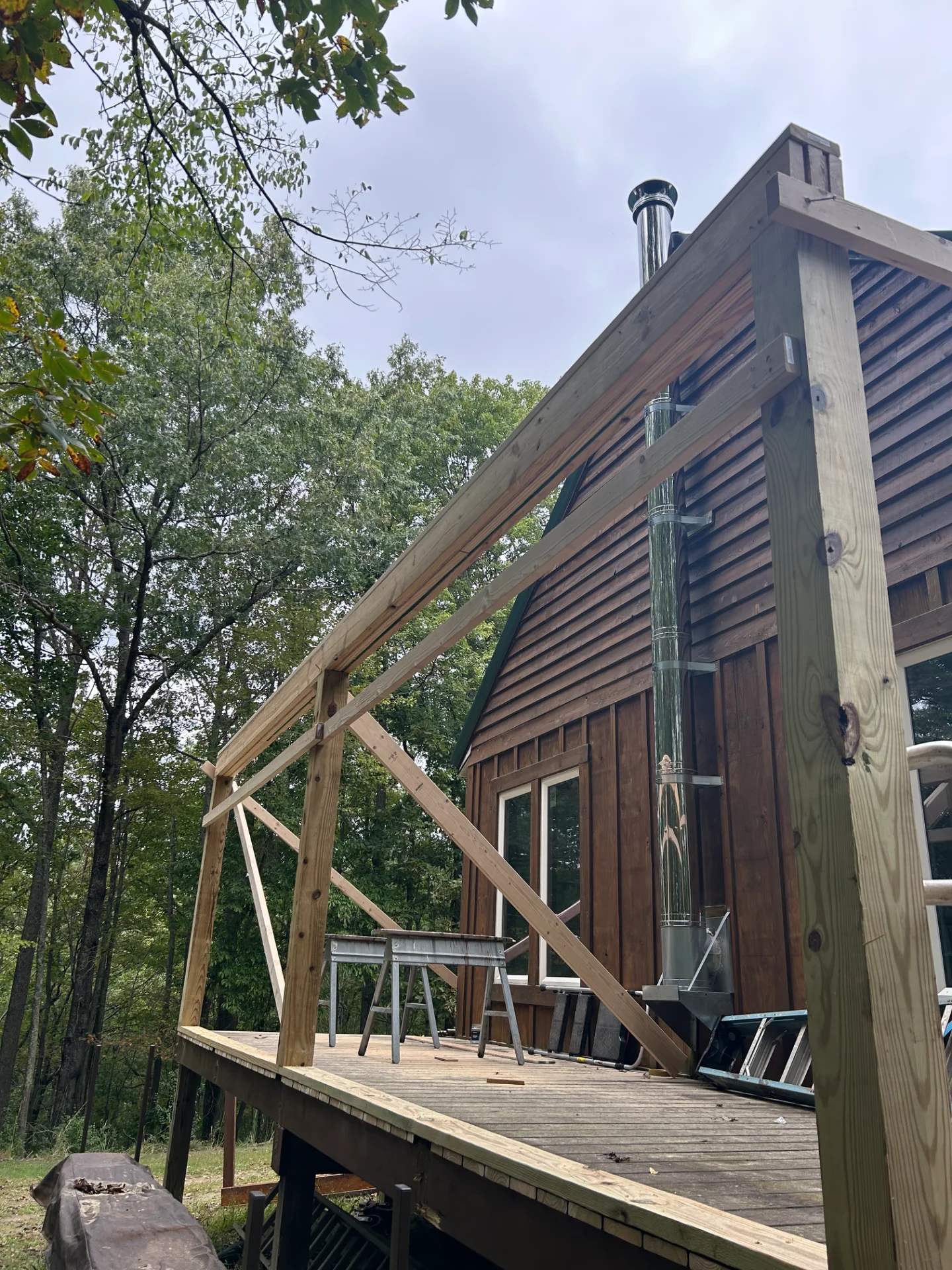

Posts erected and the beam installed. Built the beam in place (total overkill) w/OSB glued/screwed between each 2x6. It’s not going anywhere 😁.
Starting on the porch roof proper tomorrow.

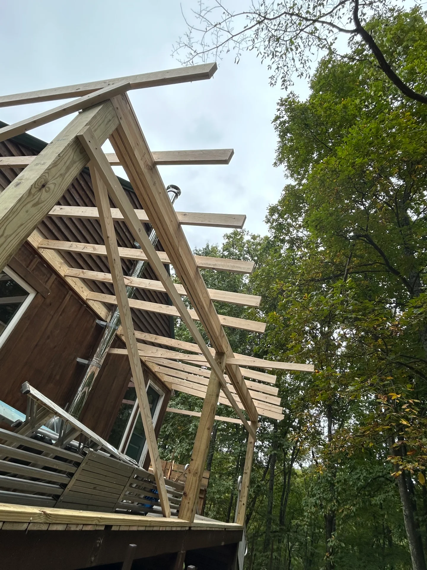

Progress on the hill. Despite my near medical emergency we made progress yesterday. The most difficult piece to the deconstruction puzzle was removing the last two courses of cedar siding before we could mount the ledger board.
2x8 ledger board. Used 16d framing nails to secure it initially. Then I came behind the nails with two 4” timber screws every 16” to finish securing it to the cabin.
Should finish up today. Purlins are on deck.

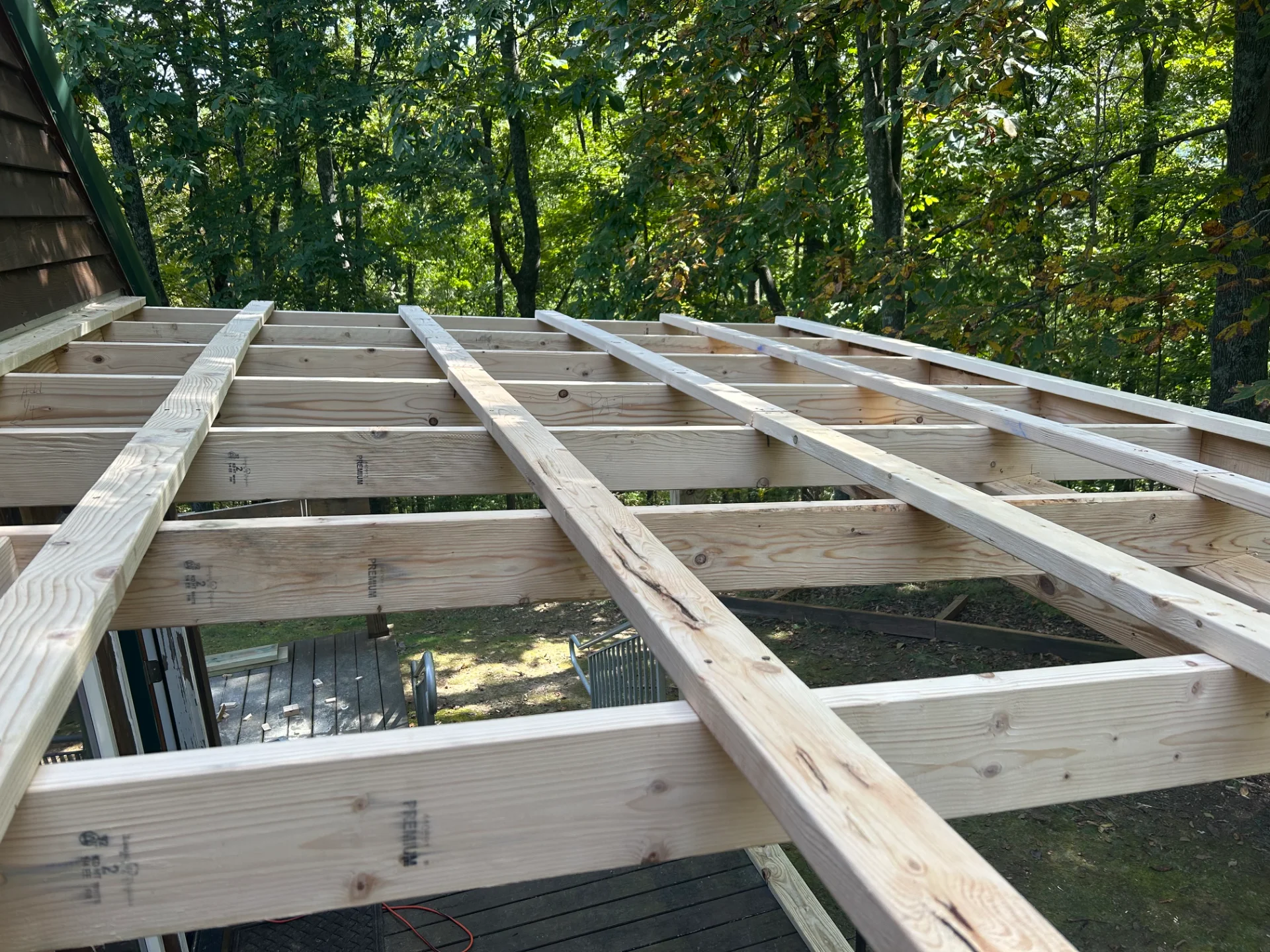

Purlins are on and I’m happy to announce there are no injuries to report. 🏆
OCB has taken to frequent cigar breaks while I “catch up”. Probably to admire my work..

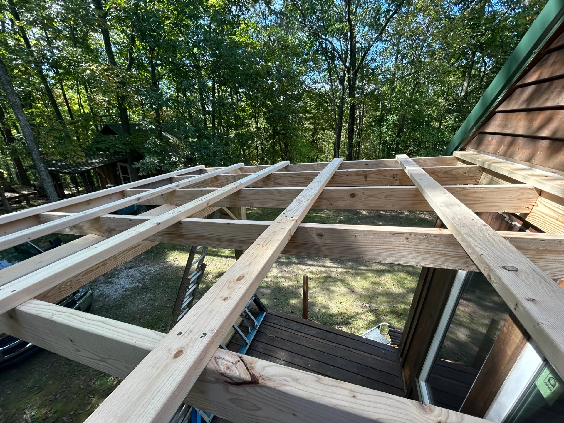

Finished up all the framing today.. 🎉 . I’ll phone in the metal order tomorrow AM and schedule a pickup for Monday AM. Good locally owned family business. All custom cut (if needed) with no up charge for odd lengths.

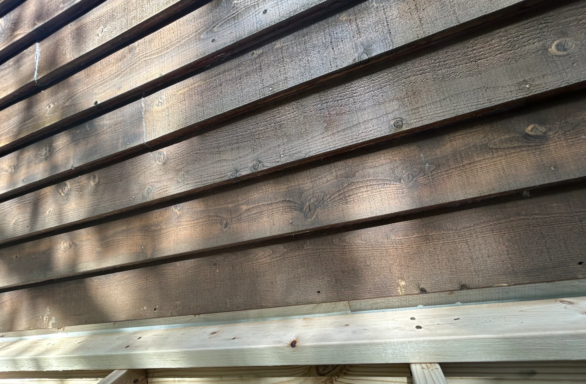

Absolutely. About 24’, give or take. Removing the bottom two courses of cedar without damaging the third course was nerve racking and slow.
We test fit a piece of metal today to make sure we had a workable solution. Not a great pic. There’s just enough wiggle room to make it work.
When in doubt, go up a course. Familiarize yourself with Masterseal NP1 as well. Nothing else comes close. You probably won't need it for this application but around windows, doors, etc. it's one and done.
Nothing better than a nice bourbon under a "tin" roof while it's raining.
Edit: I just looked back at the photo. I wouldn't even think about trying to get flashing in under the first course of siding above the header. It's too close at an inch or so. Go all the way up to the next course and use NP1 to seal the flashing vertically just under the course above. Just my "not an architect or a contractor" suggestion so take it for what it's worth.

Looks like Solar Seal 900 might be a little more elastic so possibly the better choice for your flashing. I will say that I have never seen NP1 pull away or crack in a brick to window (usually aluminum clad wood windows) or wood to wood application. NP1 can be very difficult to work though so probably better to stay with what you know.

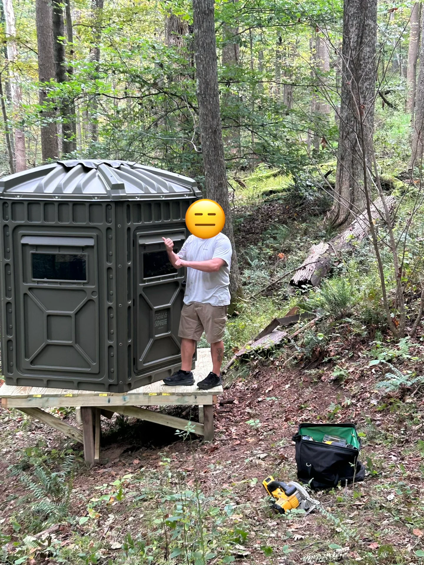

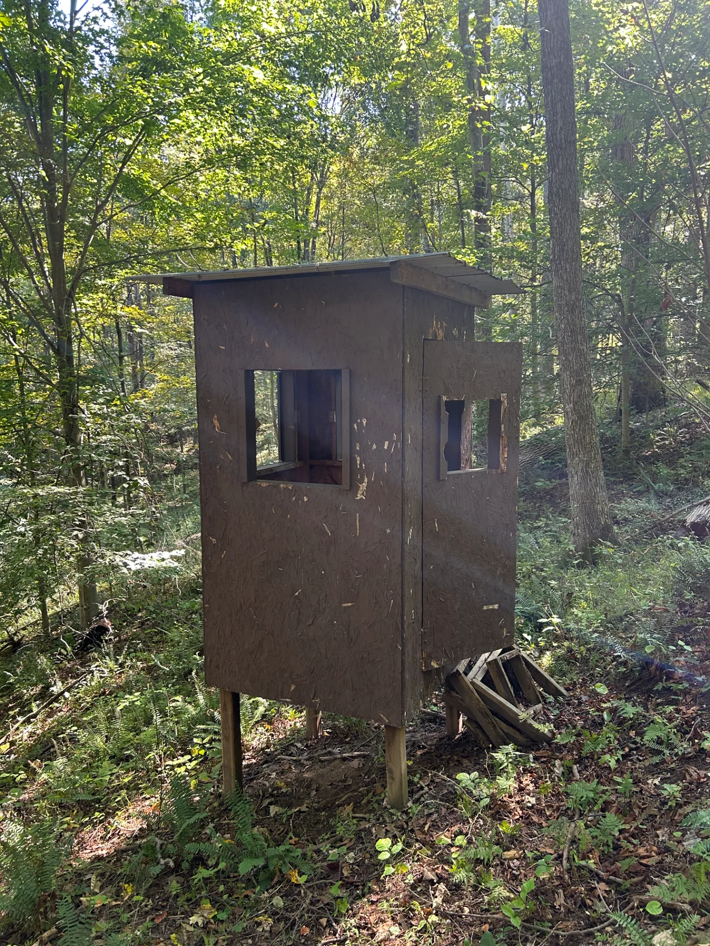

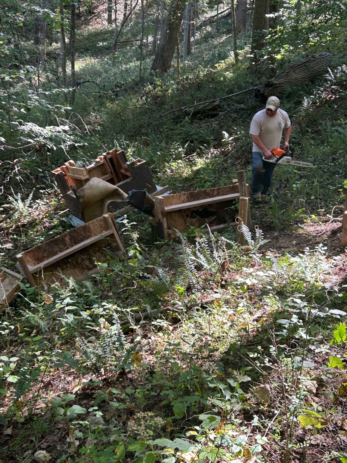

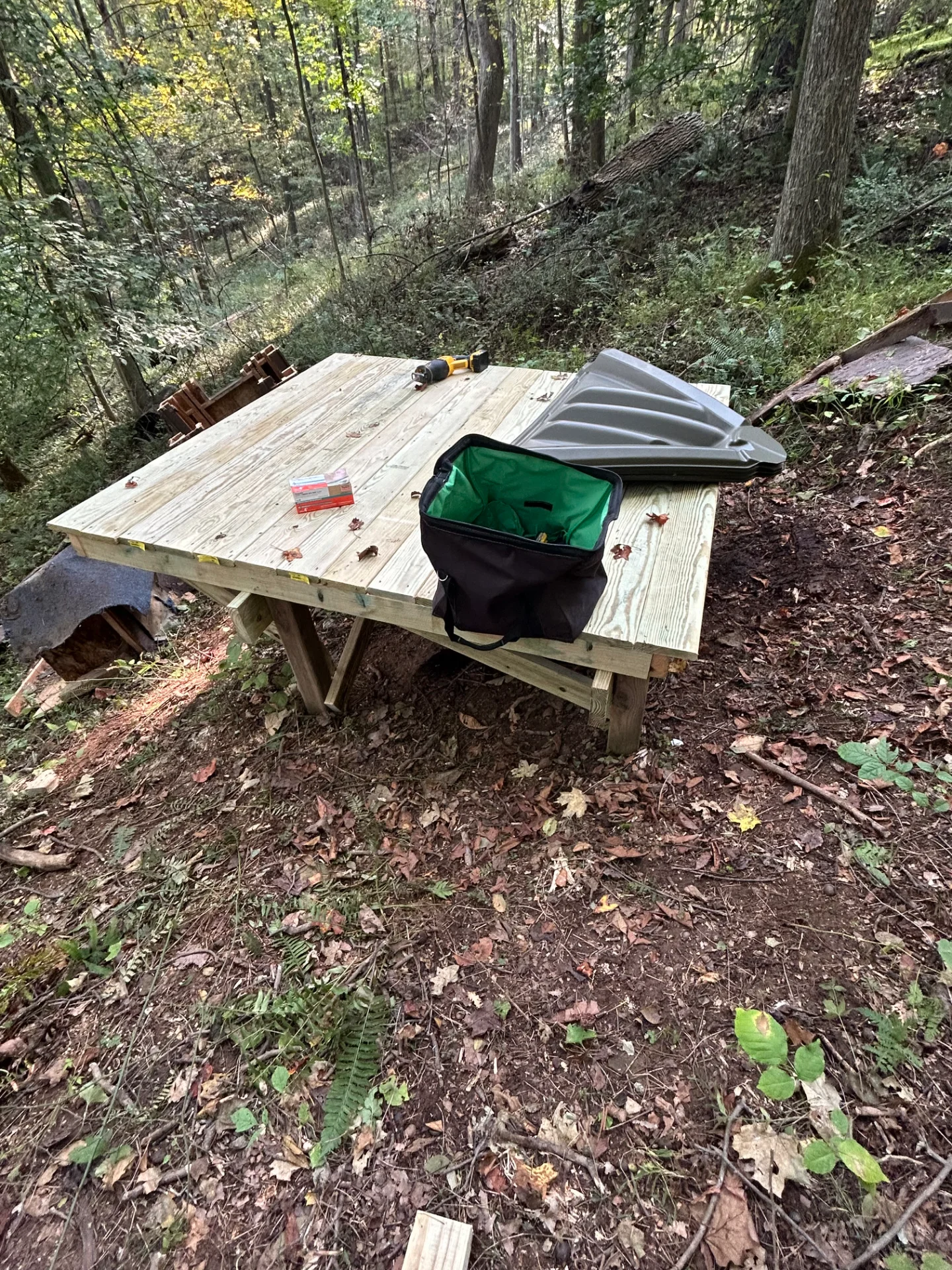

The outhouse is no more. I don’t know exactly when the outhouse was built and I’m not 100% certain that Charlie built it either. I don’t recall seeing it on my initial inspection pre-purchase. I remember discovering it in the late fall after the understory/foliage was down. It’s in a beautiful location with a panoramic view of some choice whitetail habitat.
Hunting buddy laid claim to it about ten years ago. It was three years ago that same hunting buddy forgot to replace the windows and the slow spiral into decay began. The structure itself is still relatively sound but, it was time. The local fauna had taken over and it was more wildlife habitat than stand. So much so that one of the local denizens had taken up permanent residence (last pic) inside hunting buddy’s swivel chair..

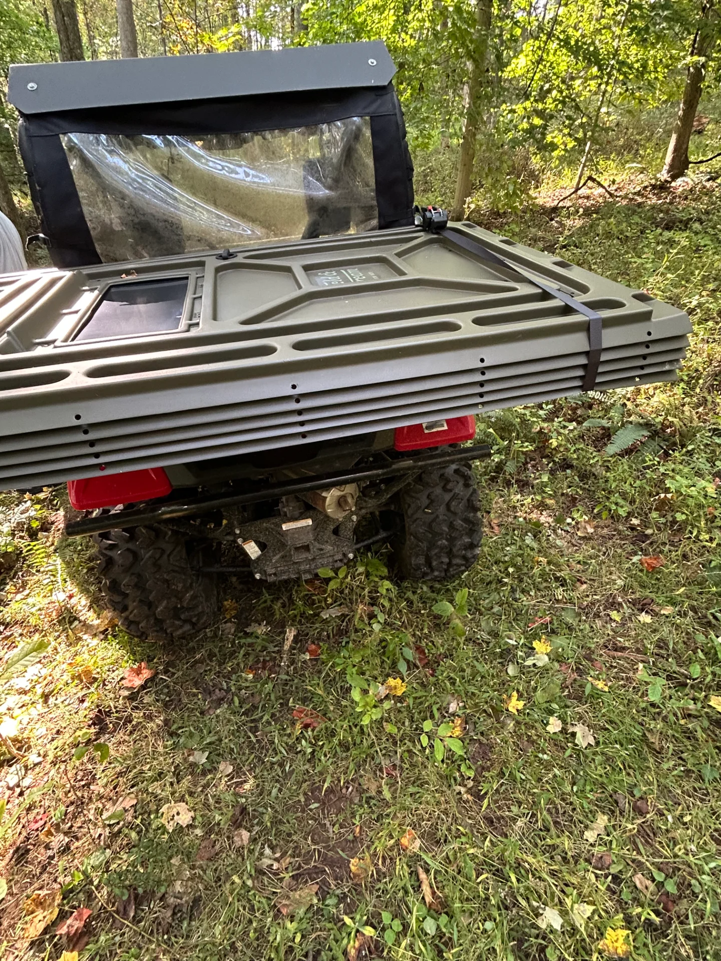

Once we dismembered the old structure a new deck was installed. The new “hooch” is a modular design under the Field and Stream label and is available local through tractor supply.
Spent a couple of hours behind a chainsaw opening up a route to the build site.
Delivery of the pieces, parts and accoutrements was made possible via the Honda SXS (work horse).
We’ll need a different designation for the new stand. The “New Outhouse” doesn’t seem to work..😁
Went up relatively easy with only one trip to the hardware store for additional washers. Build time was about one hour. Still need to add a vapor barrier and a sound deader for the floor. All in all not a bad product. Actually thinking about adding one or two more that will replace some exposed ladder stands. Old men like (need) their comfort..
