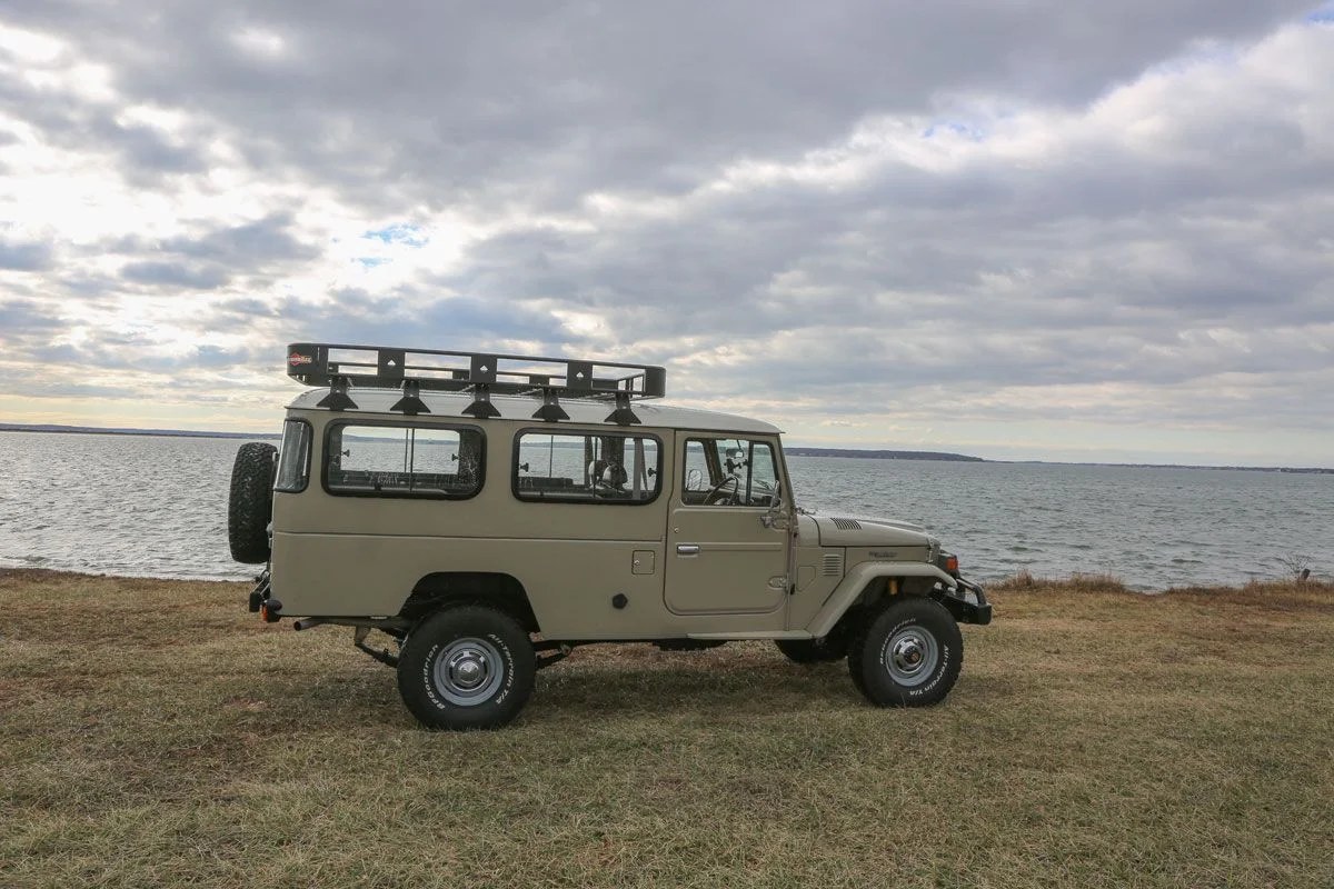

I would imagine this is obvious to some/many of you but a new development with my Troopy, below, which is generally running like a top.
On two separate and relatively recent occasions, the truck has been sitting somewhere for a few hours and when I go to start it, on turning it to start, it makes the harsh buzzing sound as if I were trying to start it and the engine were *already* running. I can only assure you that it's not already running.
The last two times, I've turned the key twice (or three?) and it makes that sound. On the next key turn, the engine starts normally and no issues after that.
What's going on here? What's the false positive that's occurring to make that sound even when the engine isn't running?
Thanks in advance,
Evan
