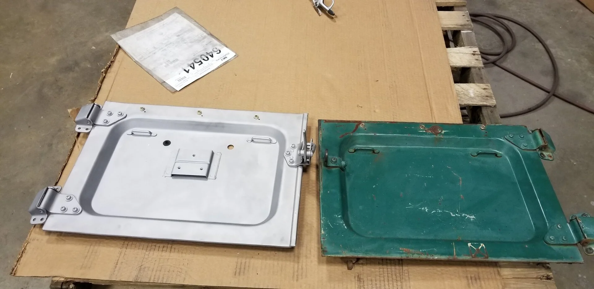

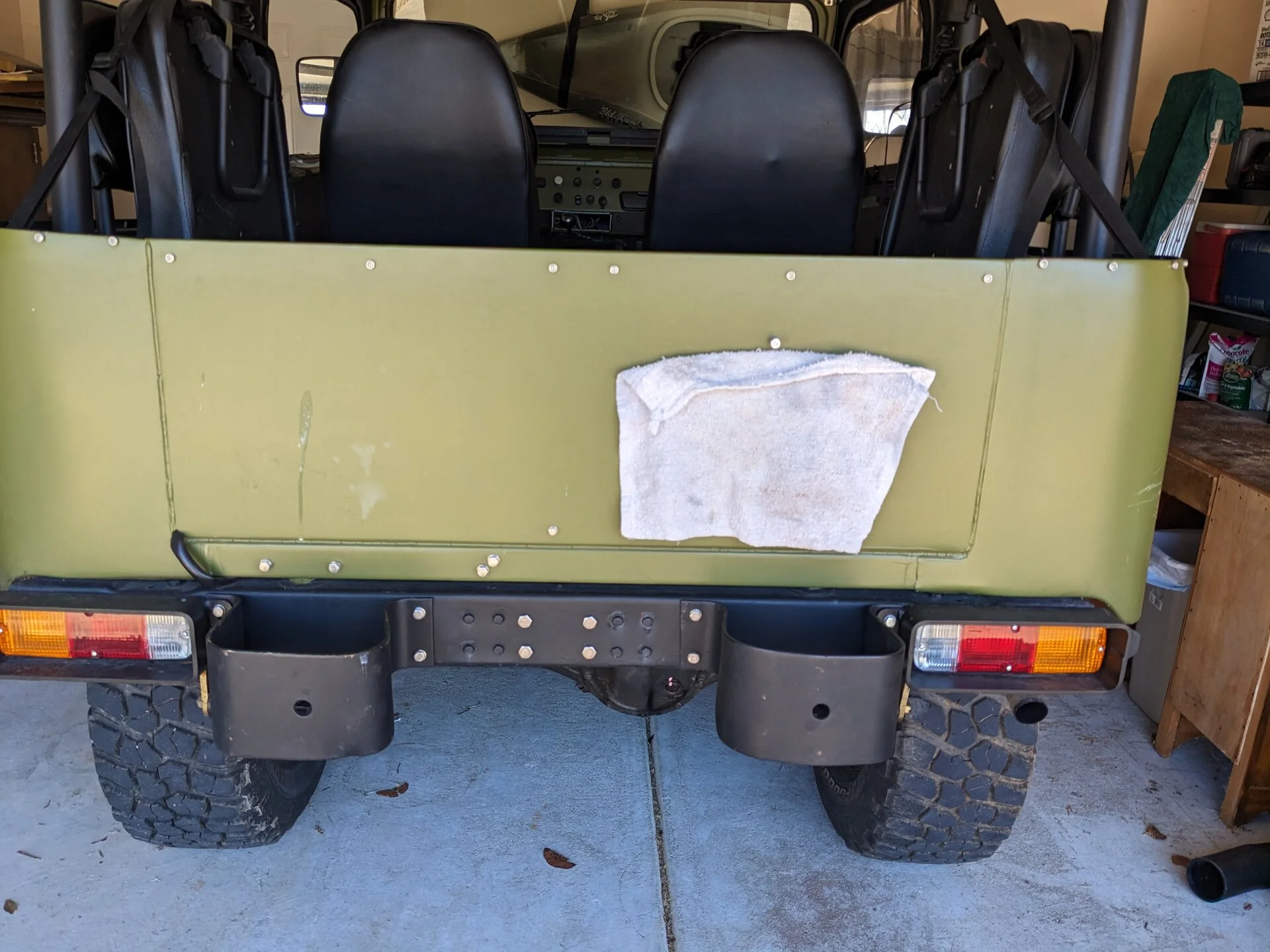

I recently bought a 1980 FJ40, and was fortunate to have gotten one with very little wrong with it mechanically as well as with regards to the body. One of the previous owners decided to weld in a panel where the rear half doors go, and when it was sold to me he gave me the oem doors which I've had media blasted and they are in pristine condition now.
I had combed the mud forms for how to go about getting them back in place and deal with the lighted license plate holder and, since they still have the hinges as well as the "Bestop" rivets, it should be a relatively simple matter. However, I've seen an overwhelming amount of posts in here where people have engineered (either from scratch or by welding the doors together) a more traditional tail gate like on a pickup truck.
One of the main things that drew me to the FJ40 in the first place was every little detail about how it looks, half doors included. I know I'll likely never fully restore this truck to original appearance but I like the idea of the doors for a more "authentic" feel.
TL;DR - are the barn doors "that bad"? I assume they're noisy (my entire truck is noisy), so that's not too much of a putoff; I imagine some rattle can be mitigated. I don't know that I would get that much more utility of a traditional style fold down tail gate - if I'm carrying a ton of stuff I'll just use my pickup truck. I guess I'm just curious about the why and why not for the barn doors. Bonus points if anyone can tell me what in the world is up with the electrical wire being "mounted" under my welded in panel (bottom left). My best guess is it's something for the tail lights.

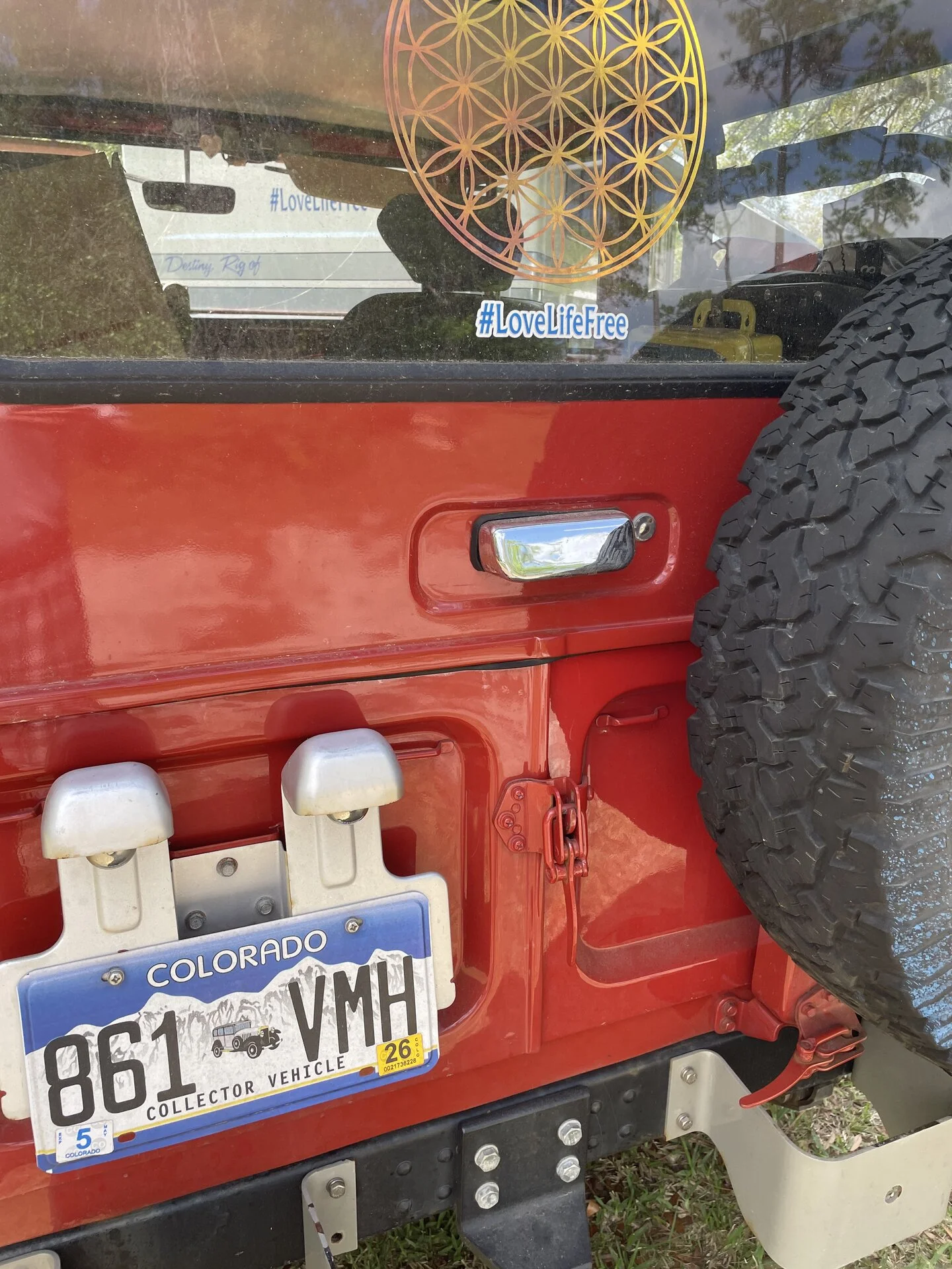

Swing out spare tire carrier has to be swung out for tailgate to open. One side of barn doors can be opened with carrier swung closed. FWIW. Makes it easier to load my hunting dogs (Britanys). I have a hard top in place.

I don't see any spare tire. The barn doors look to be for a 74 model by the bracket for the license plate holder. If from a 74 the problem.will be the overall width. The barns door in 74 were made to fit against the tub. Your tub appears to be made for ambulance doors. Looked into this before would require adding fix nuts. Trimming the lower corners and spacers between the hinge and barn doors so the doors fit flush.
That's horrible news, heh. I guess I was hoping they would "just fit" because the truck came with a "Bestop" soft top, and has the rivets all along the sides to snap it down, and I noticed that those doors also have the rivets as well - so my assumption was they were installed at some point. The fit might be why the PO decided to weld up the back though...
I have a guy that can do some metal work, can you give me some more information on the fix nuts you mentioned?

You just gotta have the struts from city racer on the glass door. 1974. The one good thing about the tire carrier in the way... no one knows how to get my back opened but me. Locks are original and useless.
Being able to pop the glass open without fiddling with the struts = gold. I like that i have a roof overhead for that space. Helps with shade or rain depending on weather. But i have nailed my head repeatedly on the inner latch, lol
