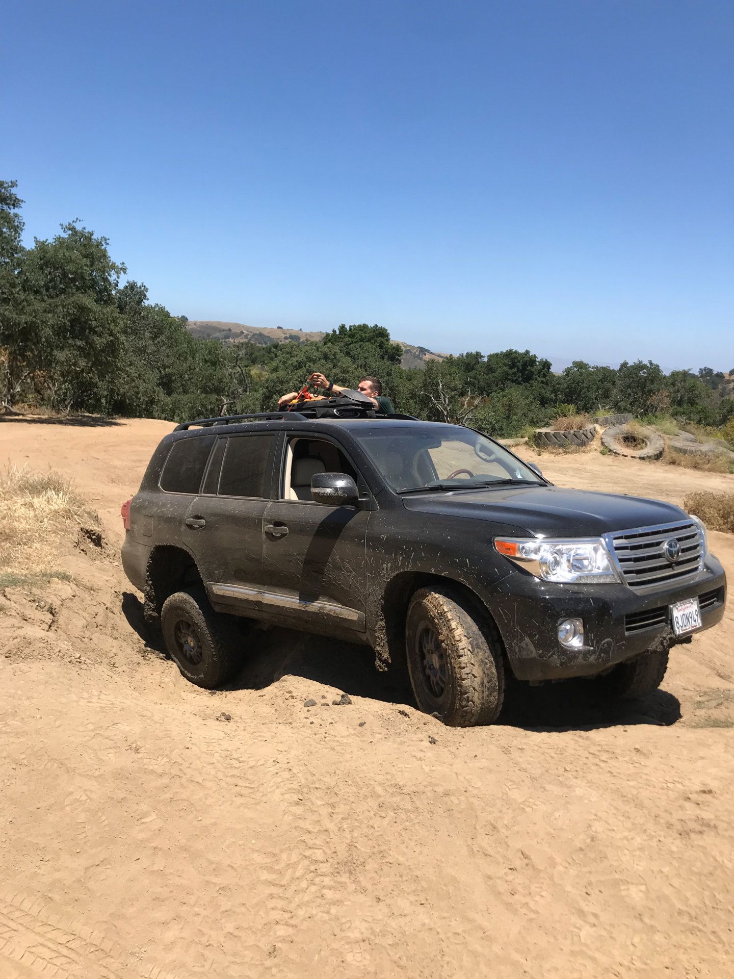

First time getting stuck in the cruiser. went thru some off camber moguls after the mud pit. Tires had no traction, had to use some traction boards on the passenger rear tire.
Do you remember whether you had your center diff locked for this? I know pics often don’t convey how difficult an obstacle is but I had a similar situation and a lot of difficulty getting out.. only to realize my CDL wasn’t engaged.
Tried bot crawl control and with the center diff locked if I remember correctly.
