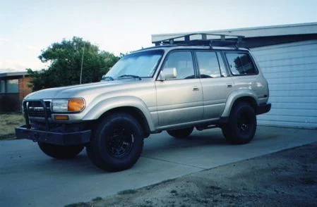

Just finished and installed my custome front bumper. We'll call it the AZ No-Bull Bar.
Here is a before pic of the fugly thing that was on my truck when I bought it.
It was 1/8" steel, terrible welds, miter cuts? Whats that!? Everyone who saw my bumper had to say it was ugly.

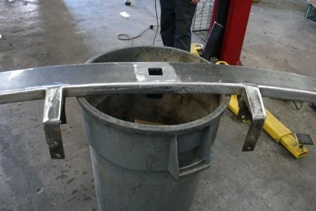

Here is the new one under construction
3/16" 2x6 tube, formed to the front of the cruiser
Receiver for winch multi mount or shackle

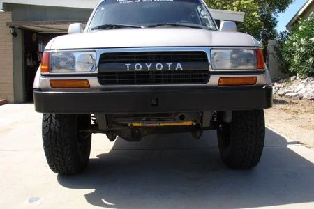

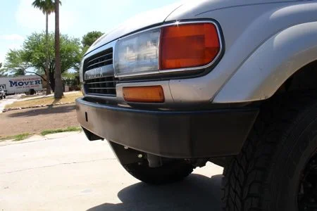

And the finished product
primered and semi-flat black rattle can
6 bolts to mount to the frame
These pics do not do it justice. It is a sweet bumper.
took about 30-35 hours of work and well worth it.
Only had 1 minor setback but this is the original piece I started with. Didn't have to scrap anything.
So without further ado
The AZ No-BullBar! :D :bounce: :bounce2:

one thing I dislike about most aftermarket and custom bumpers is they are flat or have multiple cuts to aproximate the bow of the bumper,
so how dod you put a bow in 3/16 retangular box? many cuts welds? heat and bend?

I know a guy who has a roller big enough to bend that stuff but, he's one of those guys who you really don't wanna ask a favor from. So it was cuts and welds to make that arc, and bigger cuts and welds for the corner bends. Thanks Raven, I am very happy with it and couldn't wait to finish and post up to you guys :cheers:

Well if I remember correctly it was 20 cuts to get that curve. I will have to check the pics at home and count em. It took 4 big cuts to get the corner bends.
