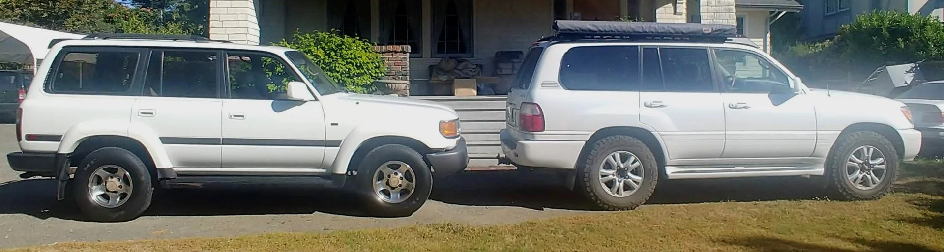

I know that this topic has been covered many times but this may be a little different.
Backstory: I bought the 100 series about a year ago for a road trip through Baja. Since then my dad and I are drinking the land cruiser Kool-Aid. So a month ago when my friends family was selling the 80 series that they bought new in 97. We gave it a new home. By vin, we think it is one of the last 200 80's made. However no lockers!
The original plan was I was going to take the 80 as my adventure vehicle (ready for most anything - besides king of the hammers - mostly overlanding and trips like Baja - thinking Utah later this year ) and my dad was going to take the hundred as his retirement car.
This is where we want you guys opinion!
Do I continue building out the 100 series for an adventure vehicle or do I start over with the 80?
both of these were soccer mom cars that had some care before we bought them. Oops! But overall in pretty good shape.
What has been to them so far:
The 100 series:
2004 lx470
Miles: 167,XXX
Overall baselined
Timing belt was done.
Heater hoses and radiator done.
AHC removed with old man emu installed.
Both diffs and trans serviced
All four brakes done
BFG ko2 33's
Yellow box
Lou's hid conversion and high beams (awesome btw)
Dissent rack
ARB air compressor
Bluetooth added
The 80 series:
Miles: 163,XXX
97 collector edition.
Rear brakes done.
Steam cleaned inside and out. (Interior look like there were a few frat parties thrown in it.)
Planned maintenance so far:
Front end rebuild.
Transmission and diff service
The infamous heater hoses.
A new radiator and upgraded blue fan.
Fix oil leaks
New radio.
New headlights.
Cleaning up the interior some more BH3D cupholders on their way (the important stuff ;))
Pros of the cars in my mind:
80 series pros:
Solid front axle
A little rougher example than our 100 series.
100 series pros:
V8
A little more comfy on the road
More done to it so far.
Things I may want to do to the car I pick (excluding doing everything I did to the 100 to the 80 +/-):
Bumpers and sliders
Kiss drawers/ sleeping platform
Rear locker at least (still trying to figure out atrac v lockers)
Gullwing rear window
2nd battery
Over the last few days, we have gotten stuck in our debate on which one to continue to build out. All ideas welcome and anything else!
PS. Cross posting to 100 series forum to make sure to get both sides of the argument ;)
