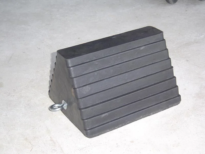

NICE! How's that foot extension holding up, doesn't it sway back and forth? Here's a lesson learned at Katemcy, carry 3-4 wide chunks of wood of different thicknesses, wide enough to put a wheel on. It will help you level that bad boy out when you get to camp. Oh, and carry a couple of chocks, too. I got these for Father's Day! Nice job on the trailer, Chad, looks great!

The leg extension moves more than I thought it would. The foot we welded on has a couple of holes in it. I drove a couple of tent stakes through them and pretty much solved that problem. The tent frame is designed to be lifted off of the trailer about 3'. I should have plenty of adjustment with the lift bars I am using to make sure that the tent stays level even if the trailer isn't. It will definantly be trial and error for a while though. I have all the parts in now to actually raise the thing up and see how it works. I plan on doing that this weekend. I will post pics of how it turns out.
Those chocks look great. I will have to put a pair of those on my "want" list.
With the tent all the way up, it does sway a bit. Once I got the wheels stabilized it was as steady as if it were on a vehicle. I need to pick up another set of chocks. I am going to make some brackets for the bottom of the poles that can be staked to the ground. That should be enough but we will see.
