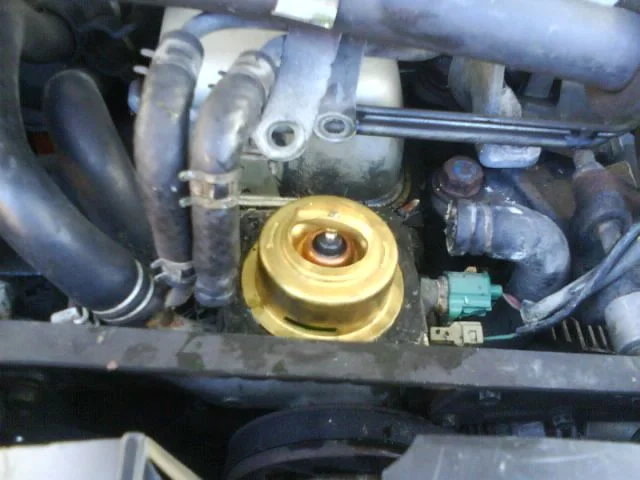

I drove to work today, the tuck behaved fine, never passed the 1/2 mark in the temp gauge. However I believed that when the thermostat is closed and the engine is running, the radiator upper hose should feel stiff, is this is correct? Could the thermostat is not seated properly and coolant is being bypassed? The one on my truck never felt stiff, the electric fan is always on and supplements the OEM fan. Like I said, the truck performed fine, even hit a traffic jam.:confused:
I think it would be hard for the thermostat to be not seated as the thermostat fits down in the base of the water outlet in the groove, the outlet gasket goes over that, and then the o-ring is installed. I use a thin film of blue gasket sealer on both sides of the outlet gasket (optional but I do not go w/o it), and snug it down.
The upper hose does feel stiff when hot. I would make sure: 1) stat is not upside down as it will bypass; 2) o-ring is installed/ seated and centered correctly in the top housing as it will bypass if not correct since it is a slotted thermostat; 3) check the rad cap to make sure it is functioning properly.
My temp gauge runs at half mark
Here is a picture of the thermostat placement, I believe is where its supposed to be, the o-ring is not on the picture, but its installed. The gasket is fine, I used the gasket sealer was used also, no leaks. The radiator cap is new, I wen and used a 13 PSI just like my other Toyotas. My temp gauge runs at 1/2 mark also, the only thing that could be is that by using that extra fan, the temperature is kept on the lower side.:hhmm:
Looks good/correct to me. Did you replace the o-ring when you replaced the thermostat ? Just wondering, those o-rings flatten and deform over time and should not be reused. If that does not seal you defeat the purpose of changing your thermostat...It just bypasses if not sealed...Makes a huge difference.
I did used a new o-ring, still I'm going to take it apart one more time to make sure the o-ring is placed correctly.:wrench::wrench::beer::wrench::wrench:
