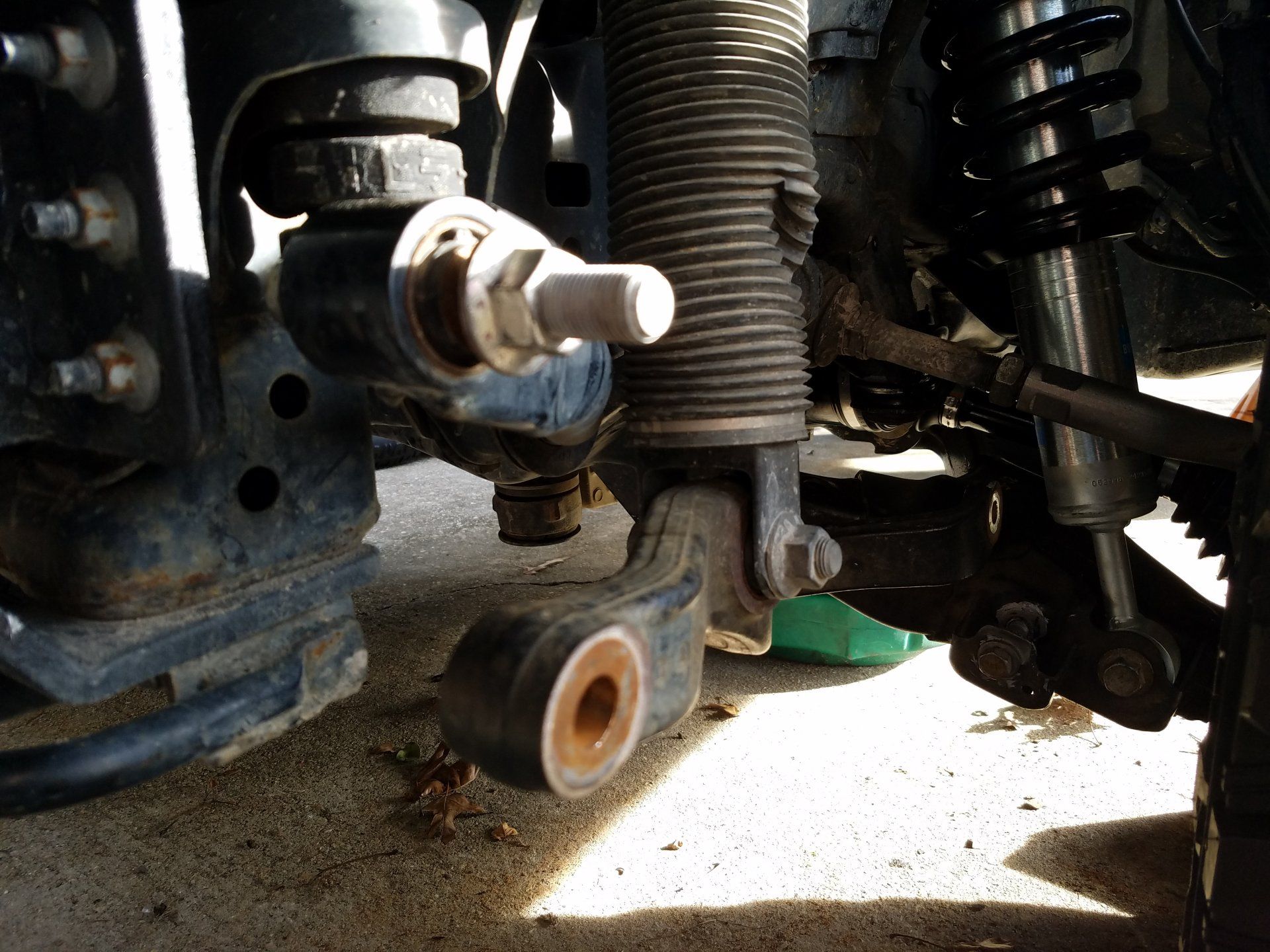

Got the truck back from the alignment ....now I'm trying to install the front sway bar. I'm trying to establish how long the aftermarket links should be. I would think that the stock links would be too short I'm guessing I have at least three inches of lift. Anybody know how much extension the front kdss valve/shock pictured has? @bloc
Measuring that shock boot on the valve from top to bottom looks like mine was it about 7in.... I'm assuming it was extended all the way out? Now it's about 6 " since I've been messing with the sway bar today.
I haven't been following completely so take this with a grain of salt.
Assuming you lifted the vehicle, but didn't really change the stroke of the suspension system. Meaning full compression is the same as stock and full droop is relatively similar to stock with perhaps an inch or so more travel, possibly with extended shocks...
You'll want the aftermarket sway bar links just about the same length as stock. Maybe .5-1" longer. Because on full compression of the suspension, you want to make sure the KDSS system is not going past whatever internal limit it's designed for.

@bloc would you have any idea how long that cylinder pictured above is? Sitting at ride height... I wish I would have measured mine before I ever tore my truck down
