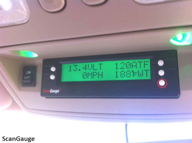

I also run a scangauge II. It gives you a real time temperature readings and will also diagnose a scan if needed. Reading engine temp is my thing, I never trust the cluster reading.
Sounds ScanGauge is the way to go. Curious to find out where's the cleanest location to place the unit? Looks looks like Flintknapper has it above the rear view mirror? Just looking for a clean install where the cable can be as much hidden as possible.
Sounds Curious to find out where's the cleanest location to place the unit?
You’ve got a number of options (depending on year, and LC vs LX):
The cheap and simple “on top of the steering column”
Both @Ayune and @BenCC have “overhead mounts”.
@CruiserGarage has an “ashtray mount”
A number of places and ways it can be mounted. I wanted mine to appear to be as 'factory' as possible and also be in an area where I could get a quick glance at it while driving and not have to look down. To that end.....I used the excellent adapter created by @Ayune and installed it. Love it.
