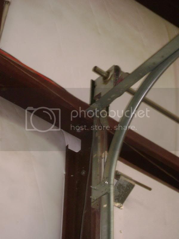

Here’ is how I solved that problem on my shop doors.
I bought two 440 lb Harbor Freight 120v winches on sale with a coupon.
The shop has two doors, one a 12 X 16 and a 12 X 12 ft, and have only had to replace one winch over the last 7 years. Relay failed.
The door uses the normal coil spring tensioner and I mounted the winch on one side of the door. The pulley that comes with the winch I mounted at the top of the door bracket like this.
The cable runs up next to the track, trough the pulley and down the door to the bottom roller. Since the door is tensioned to around 40 lbs to lift the winch and pulley will never wear out.
The winch control hangs down next to the door latch. When the door is in the lower position and the latch in the lock position I put the control behind the slide lock. This serves as a reminder to unlock the door before trying to raise the door. As you can imagine the winch will destroy the door if the latch is left locked while trying to raise the door.
As you’ve probably figured out by now, this does not power the door down, so the pull rope will need to stay attached should you raise your door so high as to not have enough weight for gravity to lower the door. A minor inconvenience considering I rarely raise my door that high. The only other drawback is you have to keep your thumb on the control until you get the door where you want it and lowered. Single lined, the winch raises the door about the same speed as a real garage door.
Cheap solution!
One of my sons installs garage doors for a living and he still is amazed at how well it works.
Cheap solution!
