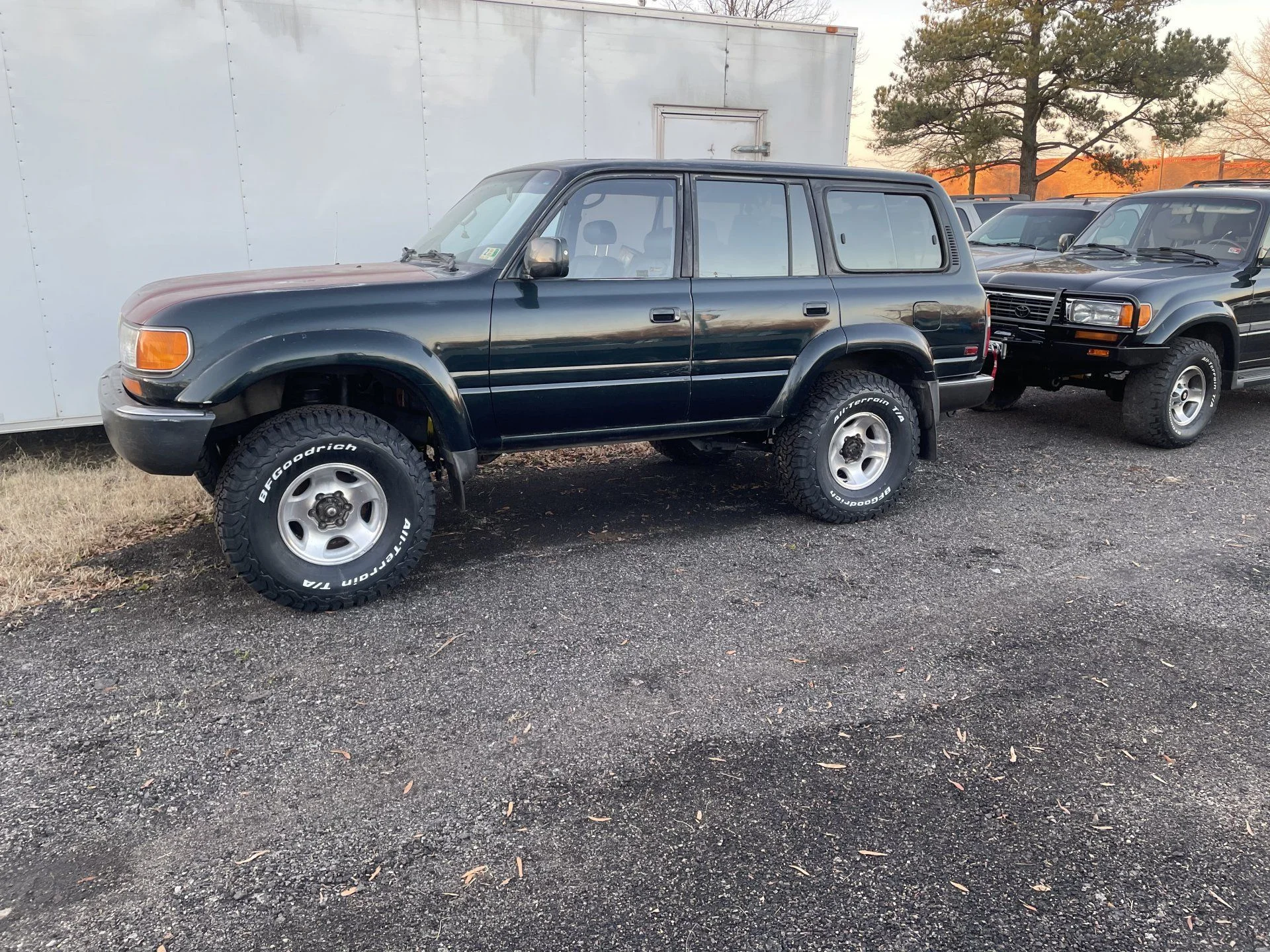

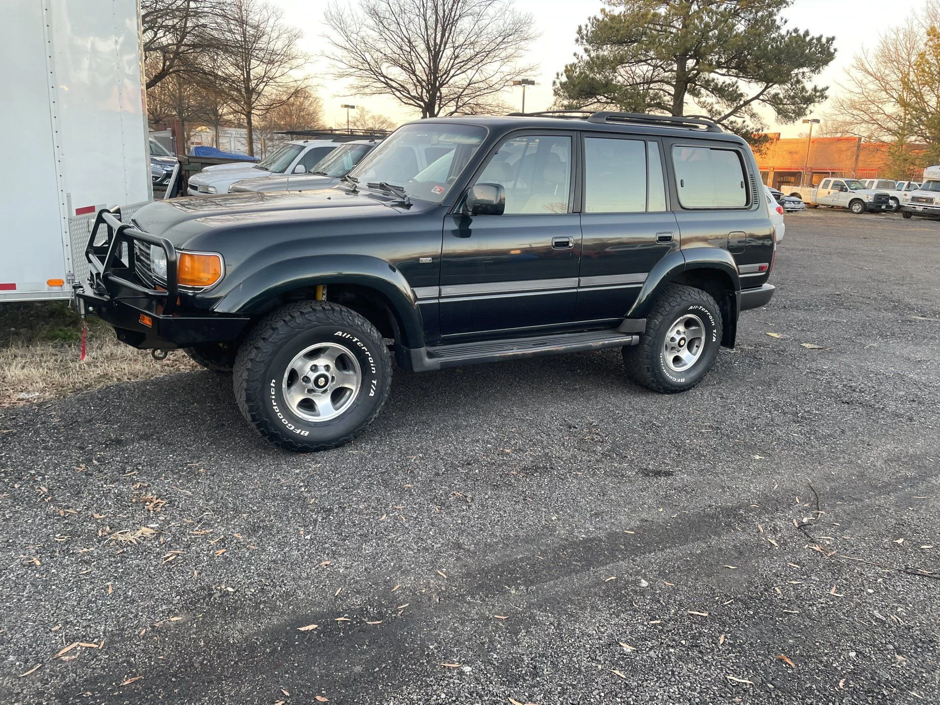

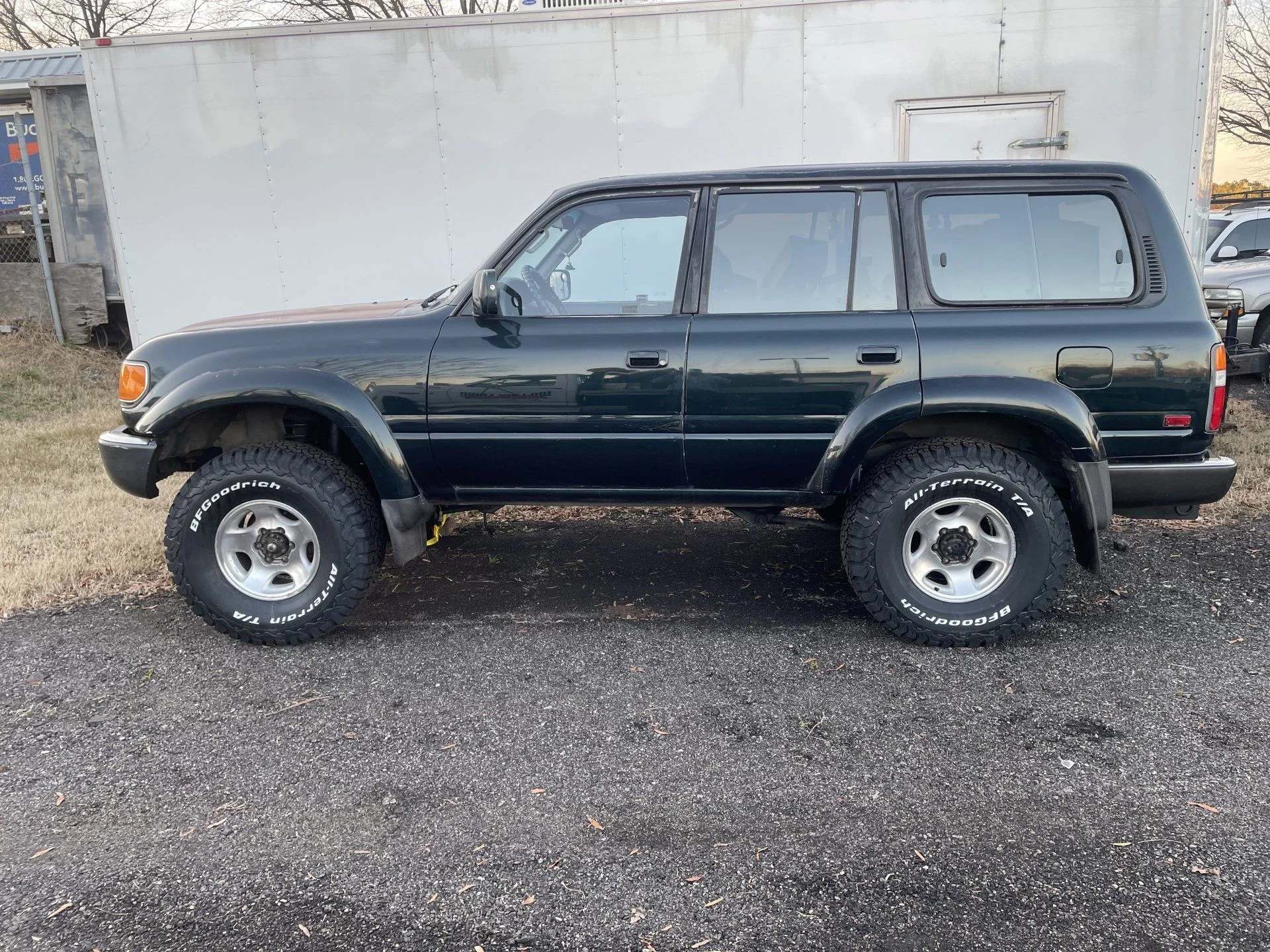

So you may have noticed I have been collecting FZJ80's. Well the plan is to build one for a DD and to look cool at the malls! I just sold one with a smallish lift and 305's on it. 850 heavy fronts, I think medium rears as it sits pretty level with a slight rake which I like. My plan is to add a ARB Bull Bar to the front and a Warn 12k winch. Stock wheels with 305's because I do not want to re-gear but I may go to a 315 on the stock wheels
I bought a used "j" spring lift, shocks and springs, thinking that with the added front end weight I would need it. Then I bought OME caster bushings, new drops for sway bars and bump stops. THEN a 80 came in the shop with "j" springs all around, spacers in the front and 305's. Thing looks like a roller skate! No bumpers to add weight to it. The front spacers looks to be about an inch and the rear still sits up higher than the front with no spacer.

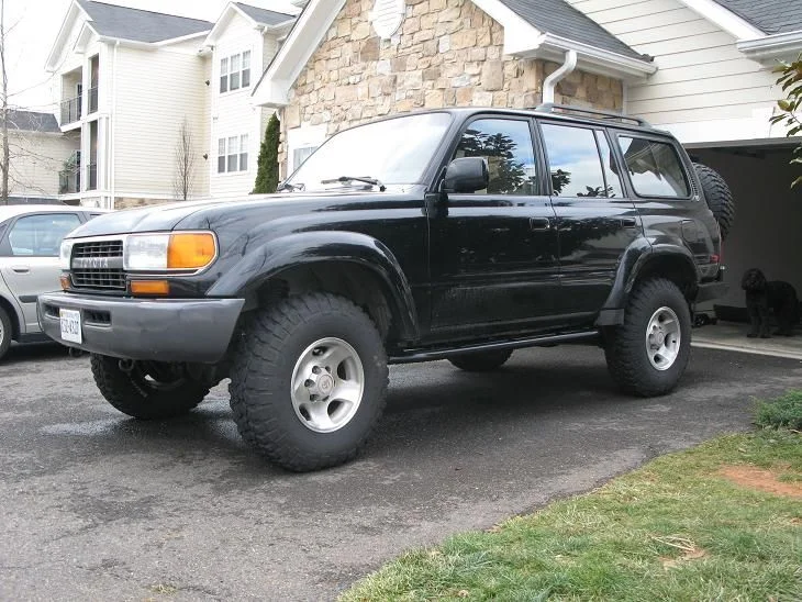

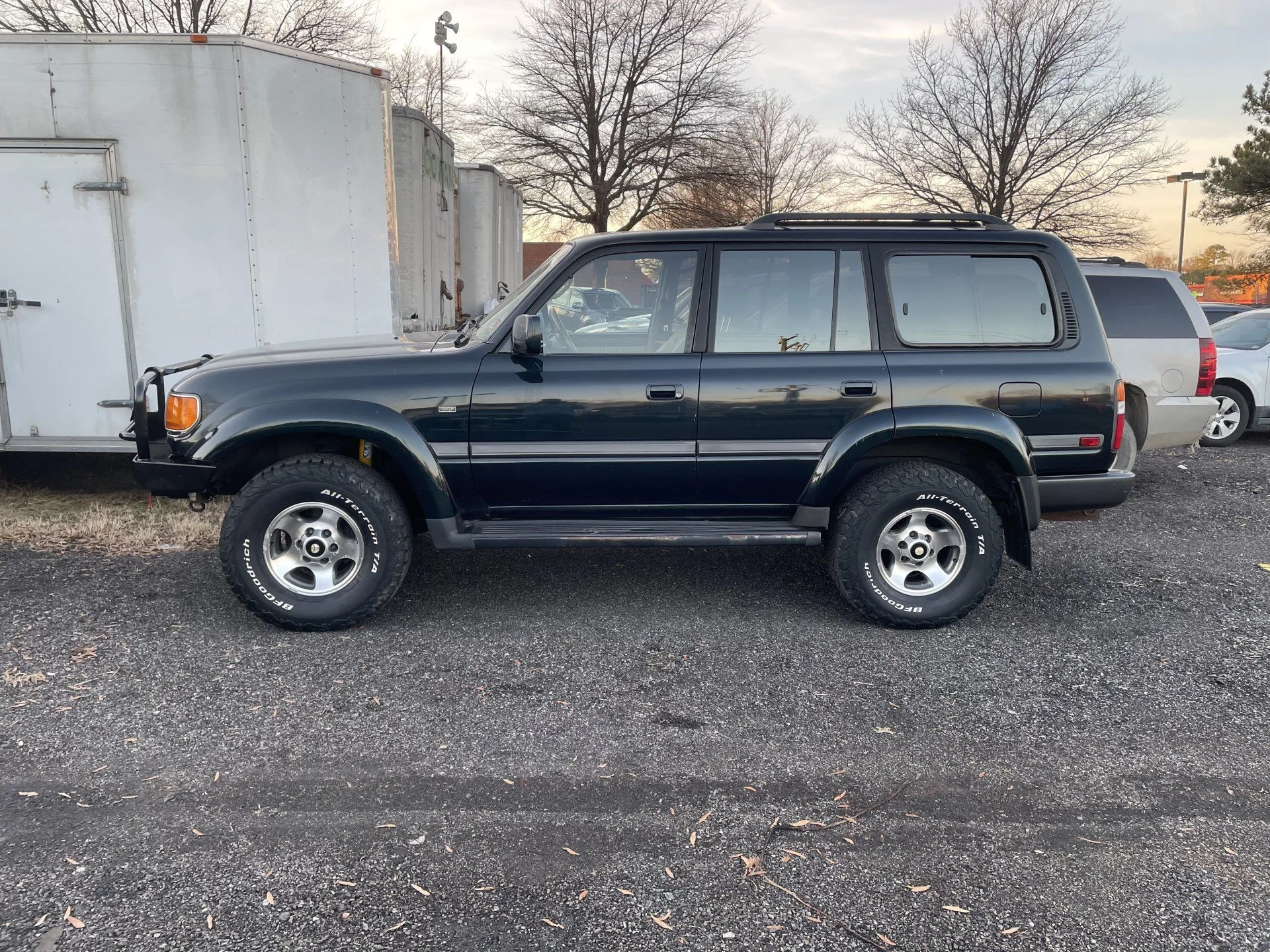

My first 80 (black) had the 850/860 (heavy front/medium rear) springs with 255/85/16 KM2s which measured out to a little over 33 inches tall and 11 inches wide. I also ran with 1 1/4 inch wheel spacer to push the skinny tires out in line with the outside edge of the fender flares. With only sliders and rear bumper I thought the stance was just right with only a slight rake forward. My current 80 has the 850 heavy springs up front with a inch spacer and extra heavy 864 springs in the back running 315/75/16 KM3s. However, it has sliders, skid plate, front ARB, 12k, dual batteries, rear bumper and OEM aux tank. Full of fuel (38 gallons) and driver it weighs in right at 6300 lbs. Measurement from center of the hub to bottom edge of fender flare is 23 inches up front and 23.5 in the rear. Stock measurement is right at 20 inches. Both trucks had caster bushings installed trough the new hotness is the Delta VS radius arms to fix caster I don't have any drive line vibrations but did have plans to install the Delta VS panhard bracket to get the rear suspension geometry back in spec. There's a guy on Mud who makes a weld in kit for much less you might want to check out. I can't say whether I'd be able to tell a difference with the panhard bracket since my truck is at Ryan's getting it along with Dobinson IMS shocks and new springs installed. Most people who have the panhard bracket installed say it helps a lot.

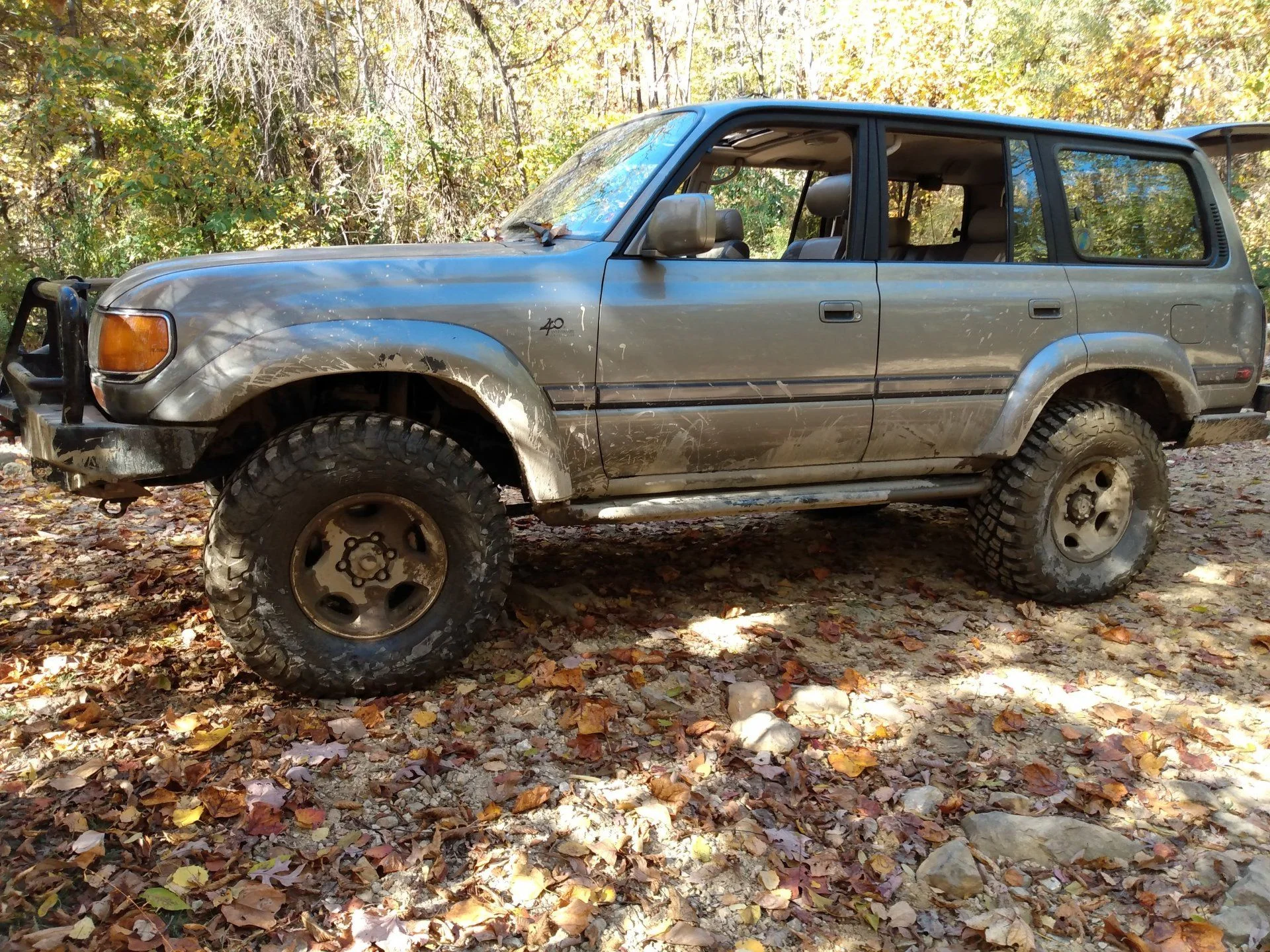

My favorite OME was J front springs and medium rear springs or stock rear springs with a 1” spacer. Personally I like 80s to look “flat” front to rear. The way the fenders swallow tires you don’t need much, if any, lift for up to 35s. I pack and build very light compared to most 80 owners so your rear spring choice could vary.
80s are weird when it comes to a DC shaft and caster correction. I’ve had two 80s. One had vibrations no matter which lift springs it had in front - mediums, heavies, Js, and some random ass “homemade” springs that gave about 5.5” of lift. The other 80 had zero vibrations running all those same springs. 🤷‍♂️
Pick the height you like and sort out your angles/caster/vibration. Anything over 2ish inches makes 35s look small.
