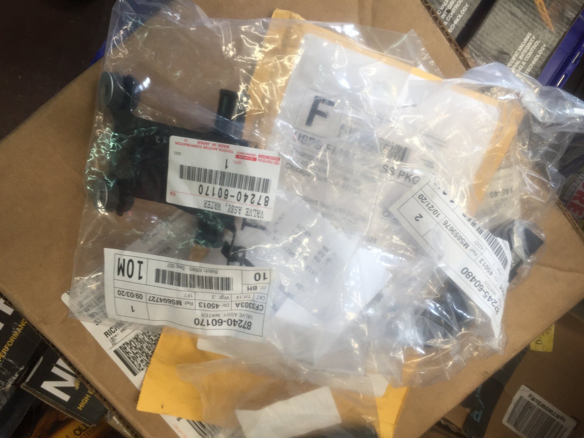

Sooooo I got the call this morning. Looks like the 80 had a puddle of coolant under it today and was low on coolant. He have replaced the water pump, radiator in the past so without seeing it I have no clue. Do the head gaskets leak externally or internally or both?
He is going to top it off and bring it to me to look at. He asked if I still wanted to buy it, this may be the straw that broke the camel's back.

Head gasket usually leaks internally. Whatever the issue is, it's likely an easy fix for you.

External leaks are likely the rear heater hard lines rusted out, or the Pesky Heater Hose on the driver side of the engine. Rarely there will be an external leak at the rear of the head gasket but it wouldn't really puddle I don't believe.
Price maybe $4-5k if it is the head gasket, $7-9k if it is just a rusted out line. Rough numbers since we haven't seen any pictures, etc.

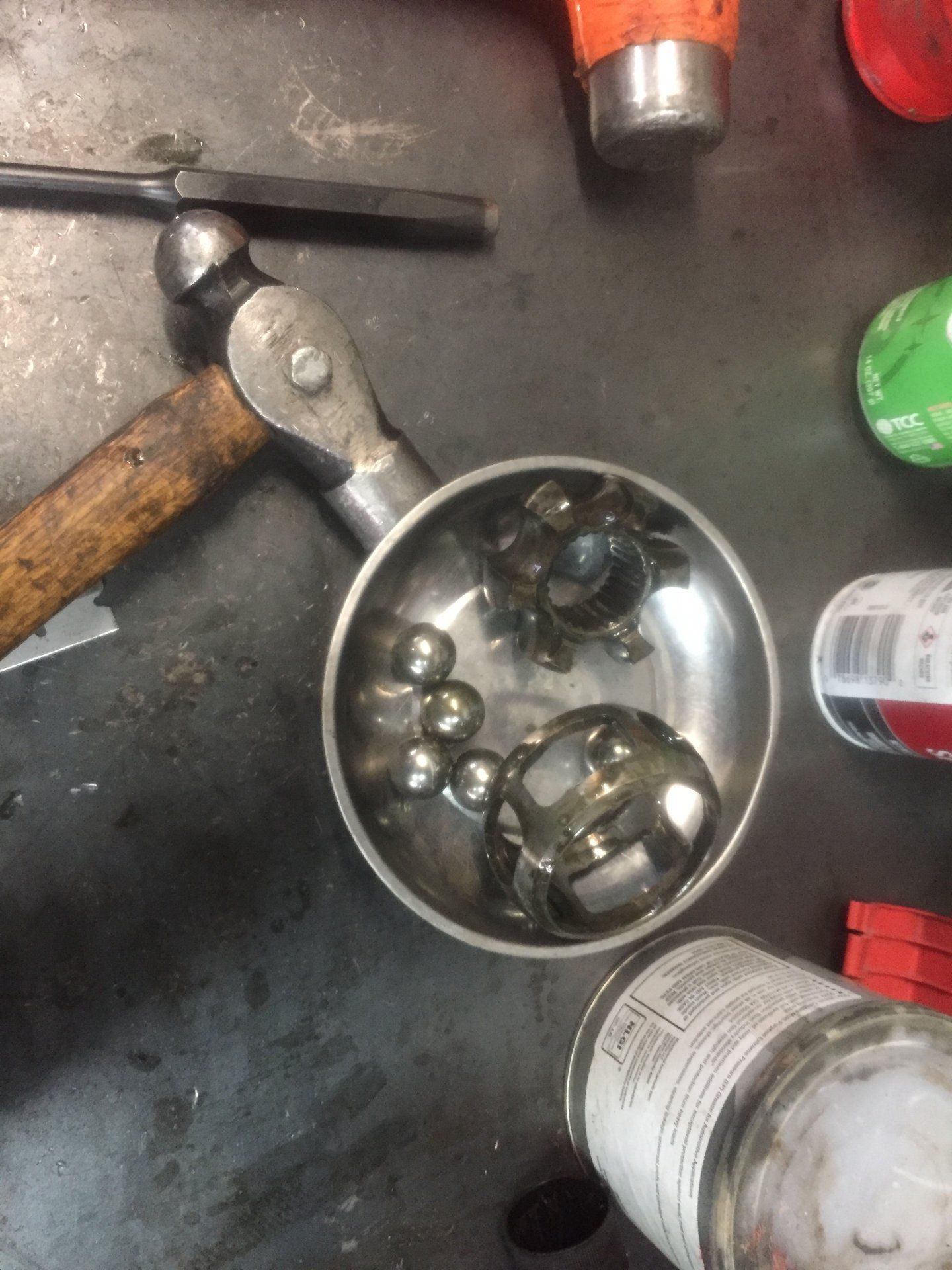

New valve is in. Changed oil and ordered a few things for it. 62 next to it is a customers that I am resealing the drivetrain and rebuilding the front axle.
