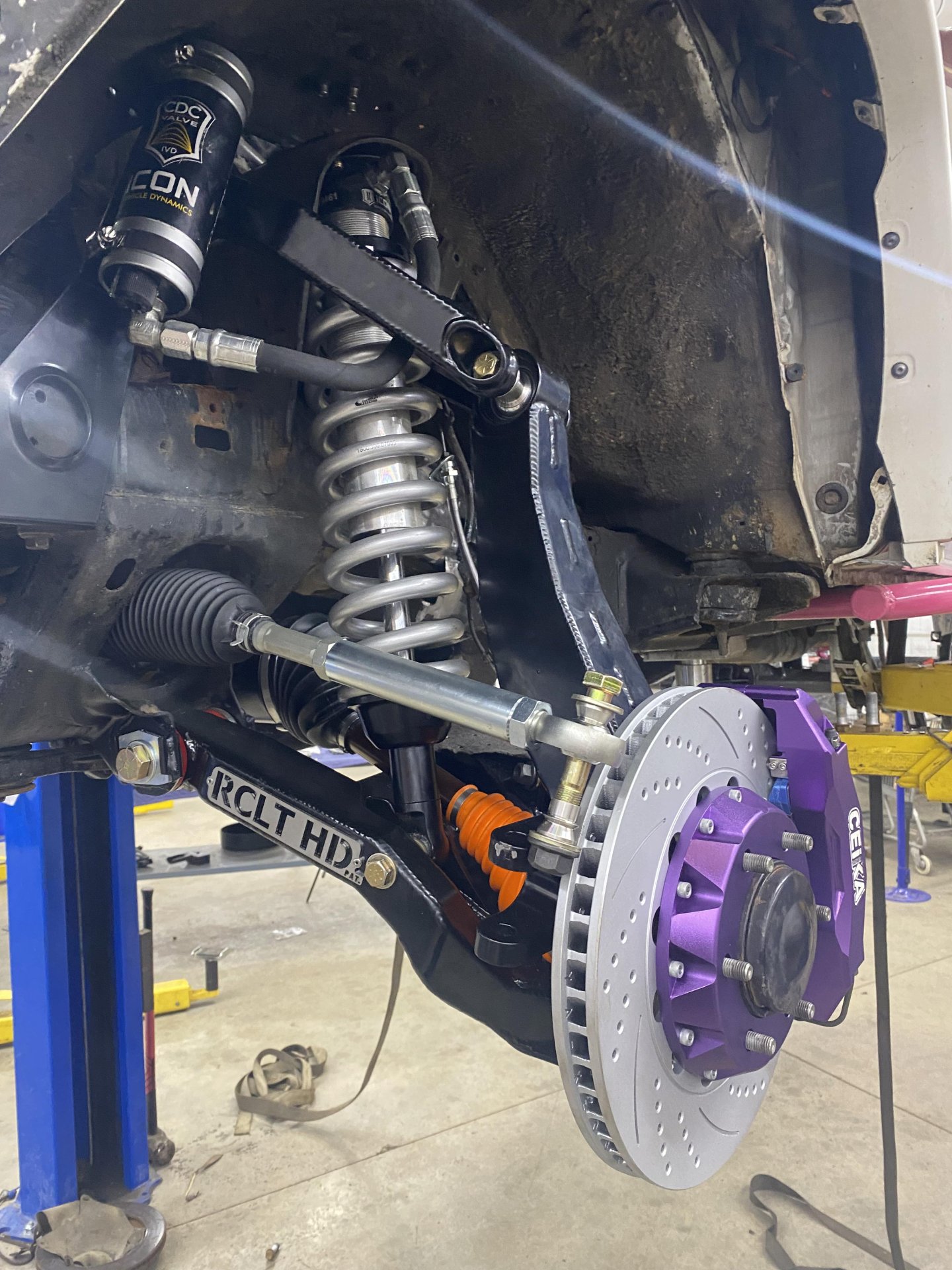

My setup is pretty protected. This one is on Maggie (her truck) since it is the cleanest pic lol but mine has the same
