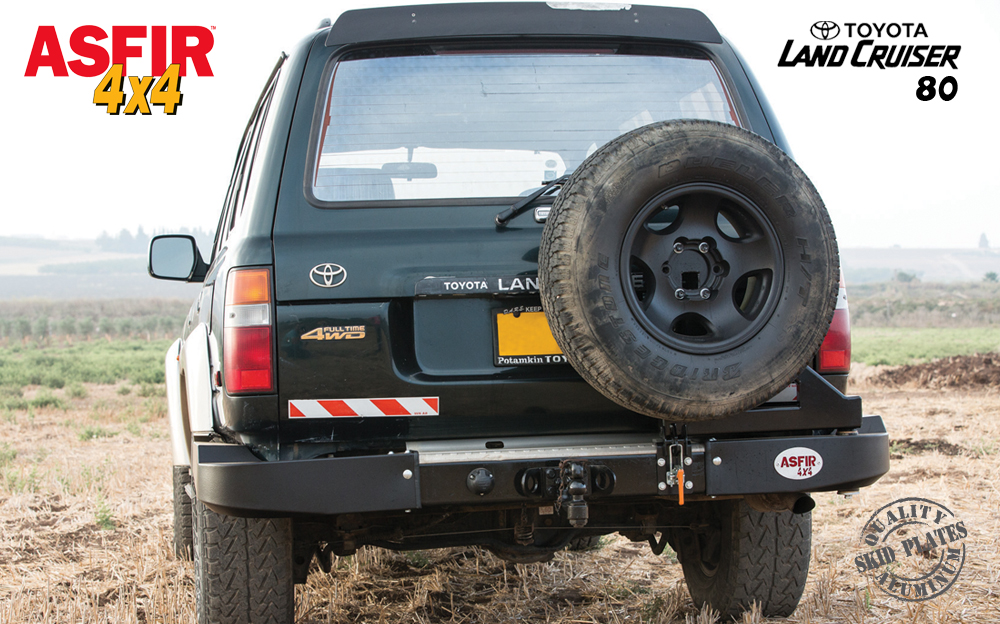

Like you, I couldn't stomach the $1500+ tag on most bumpers that included a tire carrier. I found this:
ASFIR 4x4 Steel Rear Bumper $550 Rear Bumper
Whoa! Looks very interesting. Any experience with this company and their products? No description on materials or specifications on their webpage.
Edit: I reached out to them, waiting to see if I can find other information
I got the info that they exist from a friend who said they are a company in Israel who is/was/or-somehow-affiliated-with defense contractors to up-armor vehicles.
He outfitted his Lexus with their stuff and is very happy.
That's all I know.

Thank you! I will pursue this and report back. Looks nice, may require some precision drilling.
damn that’s a bargain. Got rear ended (no damage) and a check cut for 900$. Wonder if this is what that check should go towards

A couple design problems I see with the Assfir:
The latch assembly is installed so that it could accidentally open if the rear end gets dragged. That's why the handle has been cut off in the pic directly above.
The position of the latch limits the tire size to probably 33's. One of the main reasons for the swing-out is to find a place to locate your bigger than 33" tire since anything larger will not fit under the truck in the stock location.
The latch also appears to be the only item keeping the tire carrier from hitting the tailgate if involved in a rear accident or from not holding onto when closing. I'm not seeing a bump stop attached to the arm or a locking pin in the spindle area.
I would also be concerned about the tire shaking when going down rough roads unless the wings are built out of nothing less than 3/16".
This is the bumper ONLY. it does not include the tire carrier. Just got confirmation email. It is form the bumper wings.
