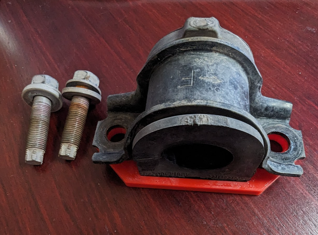

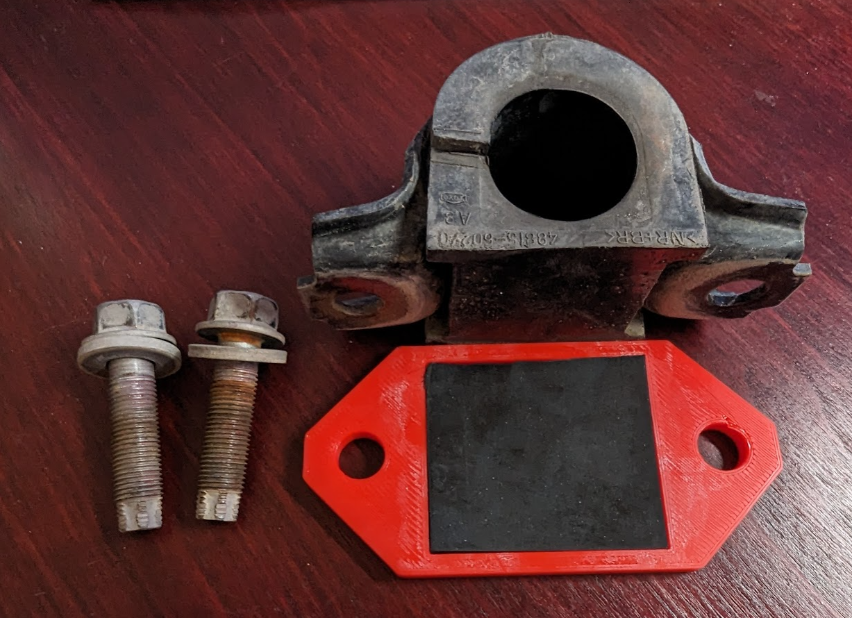

EDIT: @PerryParts came out with prototype high compliance sway bar bushings that do a better job of what I was trying to achieve. Check out post #28 in this thread.
I’ve been messing with the sway bars on the LX in an attempt to increase front end articulation. Not that it needs it and it’s perfectly slinky. But tweaking is my illness. In this case, taking advantage of added suspension travel provided by AHC Long Travel. Increasing travel creates an opportunity for a larger articulation delta between the front wheels as one side can droop farther while the other side compresses. Adding more compliance to the sway bar can maximize this articulation potential.
With the stock setup, there’s limited ways to increase sway compliance with existing hardware. One possibility that I’ve been exploring is to tweak the chassis brackets and mounts.
Spacing out the front chassis sway bar brackets by ~3/16” with thick washers let’s the sway bushing have more compliance before positively engaging. 3/16” sounds little, but because this is on two chassis points along with the motion ratio and projection of the sway bar, it adds up, and can result in useful additional sway compliance at the wheels.
Initial impressions, yes it works! The front end has more give resulting in a bit softer turn-in on aggressive turns. Yet front end bite is still strong. I know tuning sports cars from my track days, that changing the roll couple and decreasing front end bias can result in more front end traction to actually improve understeer for those willing to push enough. Large amplitude lean (like a freeway on ramp) is still well controlled and generally corners reasonably flat on account of AHCs secondary high spring rate and roll control. Long way to say it still has a good balance with more front end sway compliance. I still need to do more aggressive off-roading, but this should provide more useful articulation. I'll have a chance in a few weeks.

Don't you want the spacer to give support to the top of the bushings? It seems like, with just washers, the bushings will flex a lot more and possibly break.
This type of spacer is very common on Tundra lifts. I think the same tundra swarybar drop hardware kits may fit.
I might have missed it but what I've seen are drop spacers that move everything down. I'm trying to create more play at the bushing. There might be opportunities to accommodate both or a relocation, but you're right the tundra stuff could probably be used to riff on.
I like where your mind is. I was partially testing the idea in quick and dirty fashion with wahsers to see if it would actually give me more flex. Figured some minor spacing was okay but I agree that the bushing may see more wear like this.
To your point, I was ginning up this idea of a tunable spacer bracket. Different durometer inserts could be added as support but also compliance. I have no intent to produce any of this but it was fun to play with and put the idea out there.
Maybe something for @PerryParts to look at 3d printing. I don’t know if there is enough thickness in the spacer for their process to create something pliable.

Personally I’d use a piece of aluminum bar stock, not just washers, so the bracket is flush against the frame, but it’s a nice analysis you’ve done here.

@TeCKis300 Could you please shoot me an email at patrick@perryparts.com? I've got a bushing concept that might be pretty neat to try here - if you're willing to be a beta tester!
@lx200inAR Thanks for the shoutout!
This over extending links? I think it's cleaner I like it. Very easy mod to do too.
@turbo8 I guess you got one buyer. I need to address this on my truck.
