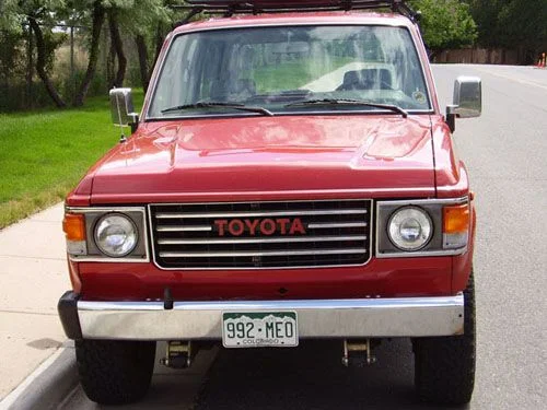

    hey red cruiser nice ride. do you need the end cap for you front bumper? i just am just building a new frnt bumper and you can have the caps from my old one if you want.

    Thanks JohnnyBoy but I have a different bumper on it now.

    Red, I like the rod Toyota badge in the grille. How did you get the paint to stick to the chrome, or is it an aftermarket or replacement emblem?

    The one I used wasn't chrome, it was white. I just sanded to the base plastic, taped it up and rattle cannned it. I did add a dozen coats of clear on top of the red in hopes that it would help. It has so far.
