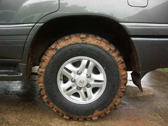

    Well here they are. Raining when I took the pics; sorry.
    I'll try to get some more pics soon. Gotta get the air pressure up too. 38psi doesn't look to be enough for the street.

    Well, I avoided the SSR's like everyone advised. Read mostly good things on the TSL/LTB's so I went with that. I decided if I was gonna go with swampers I wanted to go bias to get the true benefits of the sidewall flex and toughness vs. the radial versions. I chose the 34x10.50 as I can run them and hit full flex w/o an issue yet still get nasty grip. I think it would be THE largest size to fit without rubbing. I'd liked to have gone a little wider, but I'm confident these will get me into plenty of trouble.
    Remember, when I started this thread I stated that this is a second set of rims DEDICATED to fun, not on road manners. (helps explain those gold logos on the center caps too :) The radials are good too but the concensus is that they aren't on par with the bias plys on the trail)
    Haven't been in the greer area but I've never seen another LX w/ a TX plate in the SC. I'd think that pretty much had to be the LX, maybe my wife's boyfriend is over that way :doh:

    That is bad ass. That seriously might be the most bad ass thing I have seen in quite a while. I would venture to say that that is the first 100 to have real swampers on it in the US. Incredible. Did you go with the bb's as per my suggestion? If so how are they working out for you?
  20. tabraha
    tabraha Hello My Name is: TAD SILVER Star
    Messages:
    2,519
    Likes Received:
    665
    Joined:
    Aug 20, 2003
    Location:
    South Carolina
    Thanks for the compliments guys.
    Josh, I told the tire guys to use the BB's if the set looked like they were gonna be trouble but they got 'em balanced great with just weights inside the rim. If this set gives me any trouble at all I'm gonna go to the BB's. So far I've tried 36psi (stupid), 40psi, and now I'm at 44psi and happy. I can feel the tread blocks squirming during cornering but damn these things grip in the mud!!!
